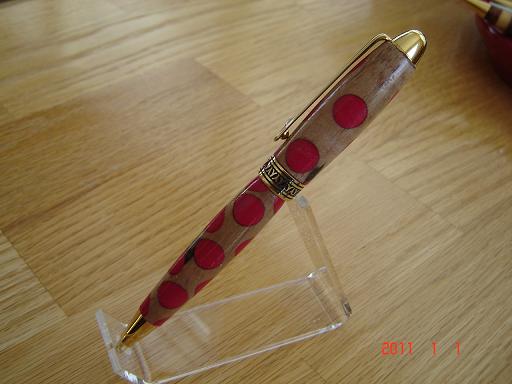

This is what I tried. Drilled holes and filled with poly clay. Works for wood, may not work on a resin blank. This was just a trial, wish I would have picked an unspalted blank,

Just thoughts.
Get a stabilized redwood blank (or a red dyed maple) from AS and an Osage orange blank.
Use a plug cutter on the Osage and fill same size holes drilled in the redwood blank with the round pieces from the Osage.
