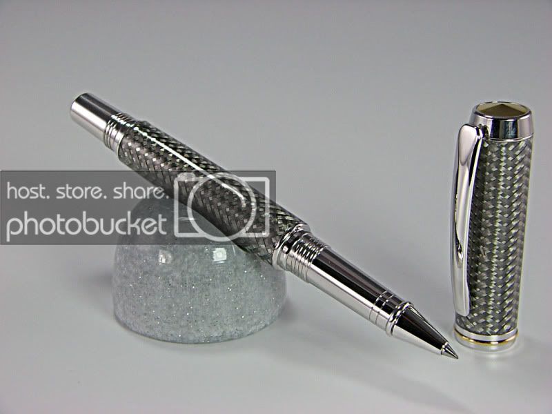

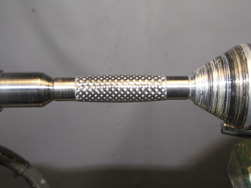

Purchased one those under-sink water hoses with the stainless steel braid covering to get the covering. Cut one end off of it with a hacksaw then cut about 3" piece off the hose,
worked the braid off of the rubber, tied it with some small wire around a Wall Street II pen tube which I had painted white then cast the whole thing in clear Alumilite. Turned it between centers, applied 4 coats of CA(Alumilite doesn't shine like PR) then polished it with Micro Mesh starting with 2400 then thru 12000.
Assembled it to the rest of the WSII components and wah-lah a stainless steel Wall Street II PENCIL. Didn't have any pens and this 0.5mm pencil had been lying in a drawer for a couple years so I though I would use it.
Some processing comments:
A question, has anyone here on the IAP turned SS braid before. I would like to find out if there is a better way to work with it then the way I had to. I plan on turning the rest of that hose braid into pens. Thought I would try some lightly tinted Alumilite, like say give the SS blue or read tint and see what it looks like.
That stuff is tough. Would never have made it through the process without my carbide tools. It ate my HSS tools alive.
Right off the bat got a big catch with my HSS parting tool trying to take the ends down to the tube ends to square it up. (sometimes I square on/with the lathe rather then a pen mill) Finally got it done with a carbide square scraper. Was holding the casting in my scroll chuck so the catch took a large hunk out of the Alumilite clear down to the braid. Found the piece and super glued it back in place. Very next touch the same piece went flying again. Took a different tack this time. Filled the exposed braid area with thick CA and hit with accelerator. After about three layers of this I had clear acrylic back above the bushing line. Took it a lot easier from then on, no more catches, got the ends squared, went to BTC bushings then turned it as pictured above and the line between the Alumilite and the CA fill is invisible
A little closer look.
Thanks for looking and C&C welcomed.

That looks amazing JD. I guess there is only your imagination to limit the possibilities.
The only thing I have ever been able to cut SS braid with is a good pair of aviation snips.
However, that won't help here.
I'd say if you could try to shear it somehow it may be better.
If you could cut the ends clean with aviation snips, maybe there wouldn't be the need to trim it much on the ends. But then what do I know about casting blanks? Nothin really.
Great looking pen though.

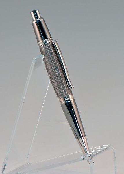

I have done quite afew metal braided pens. Here are a few.
Here is a SS Jr Gent I made for a client.
I use various methods to cut and trim the ends. Here are some blanks I made using a carbide pen mill.
I probably cast my blanks alot differently than others but it works for me. I use a good pair of aviation snipes to cut close to the tube after I glued the braid to the tube. I then cast in PR nothing else. I also use chrome tubes instead of white. It would look a whole lot better. You could have tried black if you wanted to go the painted way. I Just do not trust a sleeve on a painted tube. I would powdercoat if I wanted a painted tube on a sleeved pen. You can pick those cameleon tubes up very cheap.

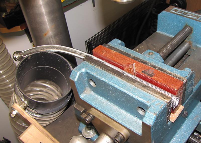

Aviation snips is the tool I am using after the initial hack-sawing of the fitting off the end and cutting a piece to length. I use the snips to trim it up and eliminate stray wires. I will post a pic of my casting setup to show how I am fasting the braiding on the tube until it is cast.

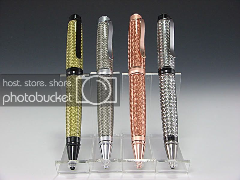

Thanks John, in the photos, except for the copper, is the various coloring the result of the resin color?

I posted these about a year ago or so when I started making them. As far as color goes they are all natural. From left to right: braided brass, braided stainless, braided copper, braided chrome.
Cameleon tubes is just a term used by a few companies. All that means is they come in white, black, chrome, black chrome and brass.

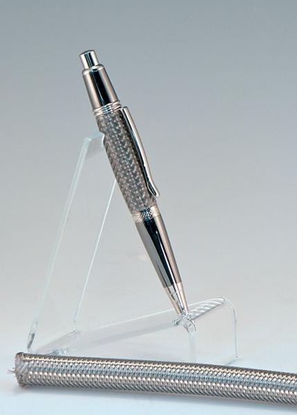

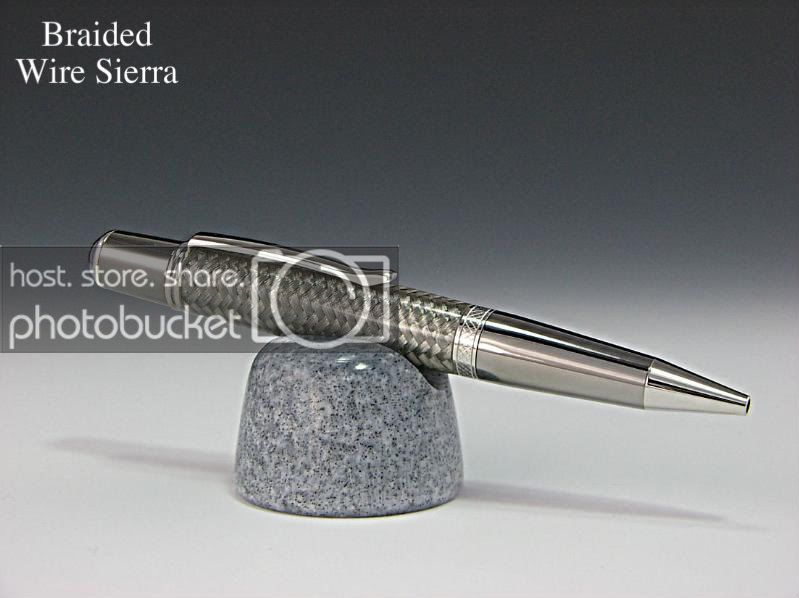

I will post 2 photos. The Sierra has the silver tined braided copper wire. The Jr Gent as posted has the Stainless. Yes they look very similar. Like I said though the copper is more dense so no see through holes and is not as shiny as the water pipe. Not sure if you can make out the difference in the photos. I do not have the Sierra any more because I have stricly went to making Stainless Steel. I also do a few other braided types too. I do not like to post my photos in your post but I am glad you understand why I did it. Keep up the good work. Casting is fun. :)
One other note that I just noticed. In the first photos (with the 4 pens) the stainless shown was actually braiding I had gotten from a different source. There was someone on another forum that started using the waterpipe hose and that is what I now strickly use and do not use the other SS braiding. The difference between the 2 is the water hose has a clear coating on it for protection from corrosion as the other did not thus that too was abit duller than this stuff, plus was even harder to work with.
