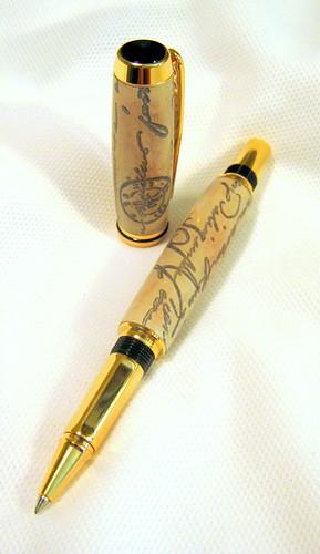

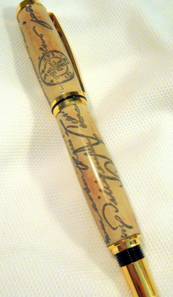

The blank is stamped and painted polymer clay cast in PR. I am not a huge fan of the color, but that is the easiest part to change. The blank was made by rolling polymer onto a tube, stamping, and then painting with chalk inks.
I recently started a thread over in the casting forum documenting my first attempt at casting. This is the second of the blanks from the batch. I had never turned acylic or PR before and blew a big chunk out of the first one.

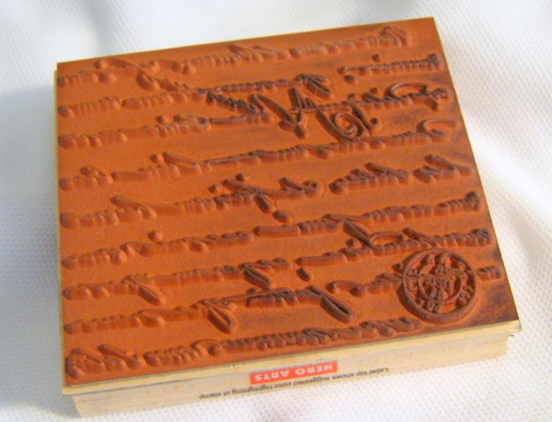

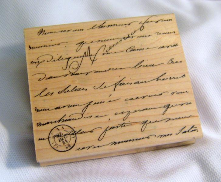

I have also attached a photo of the stamp this was made from. Thank you for looking and as always comments welcome.

Nicely done and an original application of stamping for sure. I tried, but can't figure out what document that stamp reproduces. Wanna Share?

James, I have no idea. There is not a single word on there I can make out. I just thought it looked cool. A postal stamp is one of the more eye catching parts of the stamp and I captured it on my cap. I have another stamp with music notes, but can't find the sweet spot. The spacing of the design has to work just right or you have an ugly seam area. Not attractive!

Doc, The stamping and coloring part is easy. I used a very neutral color of clay to start (cream) and wrapped the tube. For this one I left it well below the bushings due to the fact I was going to cast it. The rubber stamp is one I picked up on sale at Michael's or Hobby Lobby. To color the blank I used liquid chalk inks (any craft store) used for stamping. I grabbed some of my wifes makeup sponges and dabbed different colors on the raw tube. When I got the look I wanted I inked the stamp with a standard permanent stamp ink. The key is to find what I call the "sweet spot". It is the area of the stamp where the designs will match up after a complete revolution. It is hard to find a stamp that will not give you some type of seam or area where the design looks out of whack. Genlty roll the tube over the stamp. Don't press to hard (it will take a little practice). Once you get your design bake it and wha la!

Great idea and very well executed! That pen looks Awesome. I love the color and the finished pen looks great.... Very Elegant and Rich!

I like the color, too! it looks like original parchment type paper! Cool!
