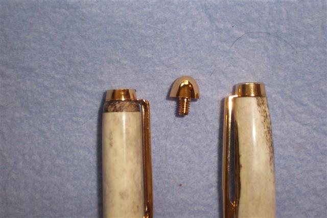

Or should I say modified finials.
Below are three finials
Left------modified "euro style" finial from a PK MON PAR
Center----Stock MON PAR finial
Right-----Elegant American finial
The mon par finial is brass and is easily turned Down on my wood lathe a@500 rpm and HSS tools
I used the mandrel sold by CSUSA to hold the stock finial in a Beall collet chuck.
This of course will lead to the situation of the plating turned off on the top of the finial but I have plans for that.

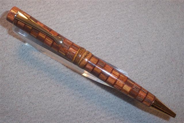

like this
<br />

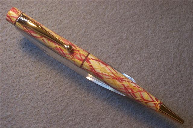

or this
<br />
but the turned down finial (with powder coat) gives me more design options.

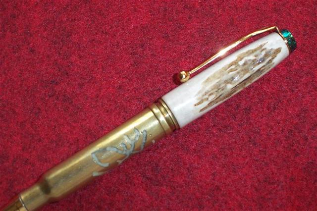

from this shape
<br />
to this shape(The color was just something I already had in the PC gun and wanted to test.(With powder coat it takes a minute to "fix mistakes"
<br />

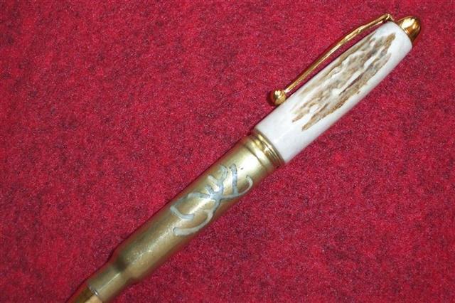

<br />Did you get permission to use the browning logo?[:D]
NO I am not sure it is an exact copy either.
I made the pen a year and a half ago, have not sold it.No one can pay me for what it is worth to me.
I did the engraving by hand(6 hours) and inlayed it with antler dustand CA.Every once in a while I polish it.
Thanks for recognizing the design,therre are others who haven't.
