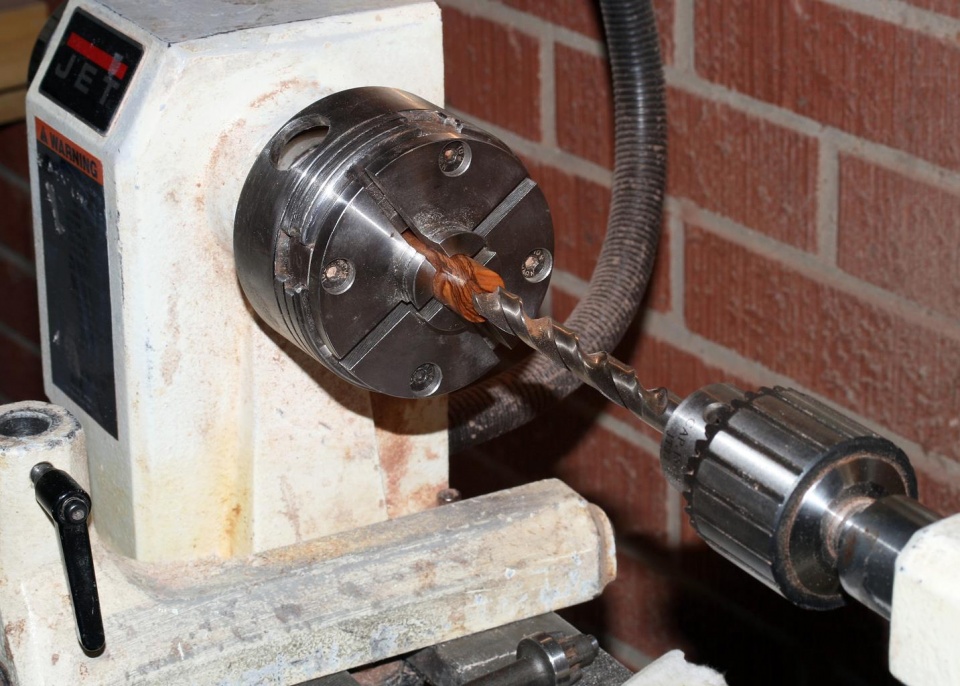

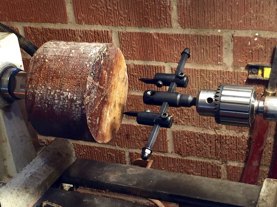

Here are 2 different setups for drilling on the lathe. Both incorporate the same design/goal.
On your video's posted you have something going on with the headstock. My assumption (since we were unable to see it in the video is the chuck on the headstock.
Put you a dead center in there (head stock) and marry them up and see where they point, then turn it on and see if it wobbles. If it does wobble with the dead center then you have bearing problems. If it runs true with the dead center but not with the chuck then you have a POS chuck. In which case you can chuck it in the bin and get a good one.
