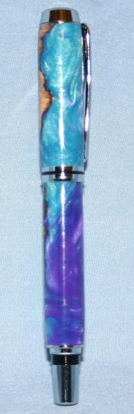

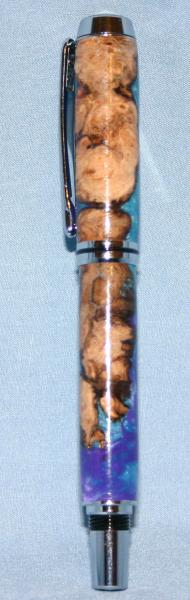

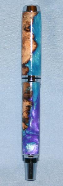

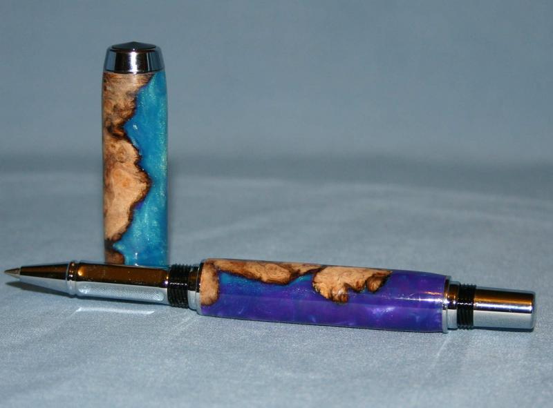

Eugene (ElMostro) appropriately named these blanks "Cancun". They remind me of the island.
Spalted Maple Burl Cancun wrapped around a Chrome Navigator. Four views of the same pen.
Thanks for looking.

Very cool. How did you finish these? I have some coming in the mail and I was wondering how I am going to finish them.
First, I recommend you turn these with a scary sharp skew.
Here is what I did with this one:
1. Dry sanded to 2000 (started at 600).
2. Wiped down blanks with slightly damp cloth, spin to air dry.
3. Applied two coats of medium CA (I was out of thin, or I would have used three or four coats of thin).
4. Wet sanded to 12000 MicroMesh.
5. Two coats of McQuires Plastix Polish. (Let each coat dry before buffing off with a cotton cloth.)
Be careful to avoid heat, from drilling to finishing. The wood and resin will react differently.
Have fun.
