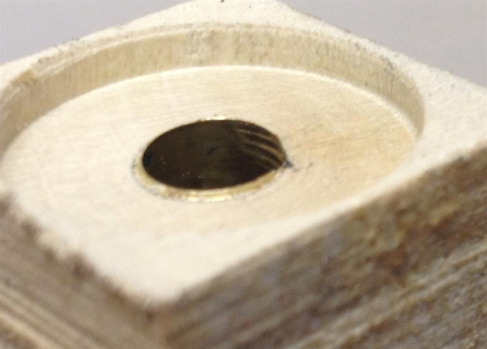

It's been a while since I've been able to get some shop time but I have my lathe set up and got a couple blanks out and glued in some tubes to make a slimline pen. However when using my barrel trimmer it leaves the tube raised above of the wood. Is that normal. Wood is Holly. Standard slimline kit with 7mm tubes. Using the correct barrel trimmer shaft.
Any suggestions, or is this correct? I don't remember it doing this before.
I thought the whole idea of the barrel trimmer was to cut everything smooth.

That happens when the fit between the trimmer head and the trimmer shaft is not especially good and there is a gap that allows the brass to slide into the gap.
One way to avoid is to be careful not to over mill. Mill until the cutter just touches the brass.
This will clean up when you seal and sand the ends. If much is present, it comes off with a file quickly. Some pens are sensitive to length so check and you may need to be a tad long on the other end.

Ok thanks, I'll check the fit of my barrel trimmer. Maybe I'll just pull it apart and then put it back together again (never thought it it) and see if it works any better.

Ken is right, when he says the fit between the head and the trimmer shaft is not good. I have the Whiteside (expensive set) and it does the same thing. I looked at the rockler set in the store and it would do the same thing. Rockler and someone else has a 7 mm one piece that wouldn't do that but it was 35$. I plan on building something to do 7 mm or buying one of the ones available for the lathe that would do all sizes, since it would not be much more than the 35$ for a special one just for 7mm. Note that this does not happen on the larger sizes because the head fits inside the diameter of the larger tubes and inside the tenon on the shaft.

This has happened to me in the past except the reason on my incident was because the tube was not glued very well. As I made one end flush I apparently started pushing the brass out the other end.

I had two end mills and when I mixed up the cutters I found one of the shafts was cut at 90 degrees and the other had a radius which was not allowing the cutter to get flush with the shaft.

I have a piloted endmill I use sometimes, and it does it. But that's because it takes 1/4" shaft pilots, and if I put a letter D drill blank in it, the letter D is only .246". I would think a dedicated 7mm barrel trimmer wouldn't do that, but mine does.

Like said above. Clearance between the shaft and cutter. There are some pen mills that have a 3/16" hole in the cutter, and a shoulder on the shaft that prevents this. Couldn't tell you where they come from. I built my own from an air craft countersink with a 3/16" hole and made the pilot with some letter D drill rod. Works great, but in cost a bit more than a regular mill did, but it is good HSS.

There is a pen mill that has a narrow shaft so the cutter cuts the brass on the 7mm tube. Alas I don't remember where I got it. Arizona Silhouette??
