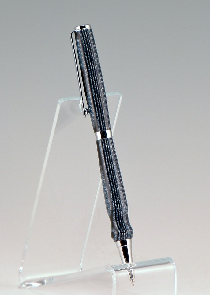

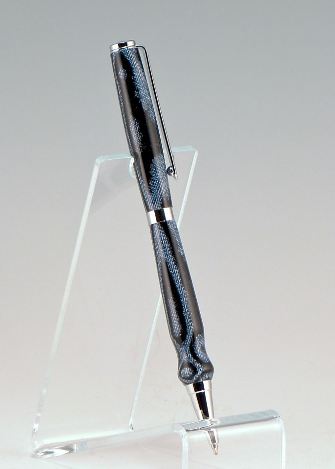

...Casting? Someone may have tried this before but I don't recall seeing it, using Cactus Juice to stabilize a roll of cloth creating a Micarta roll/pen blank. I gave it a try and here is the process I used.
This is the results, two views of the same pen.
This one shows the "cross grain" and the next one the "end grain" view. (My definitions)

A couple of comments on the process:
1. The roll or bundle still had some porosity to it so took a little thin CA during the final cuts to keep from having "tear-out" and "de-lamination". Which problem the CA took care of depended on the lamination orientations, "end-grain"(edges of the fabric) tore-out slightly and cross-grain de-laminated "sometimes". I think that a second processing with C-Juice would solve most of these problems and I will be trying that on the next go around.
2. When I pull the blank out of the oven and it had cooled I looked at it and it was very wide compared to thickness and I instantly thought, "Oh good, it will make 2 blanks", well it did but I think if I had taken a single blank out of the center section it would have been better looking. I will also be trying that on the next go around.
Comments and suggestions appreciated.
