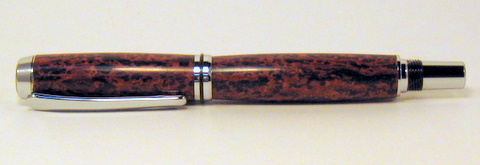

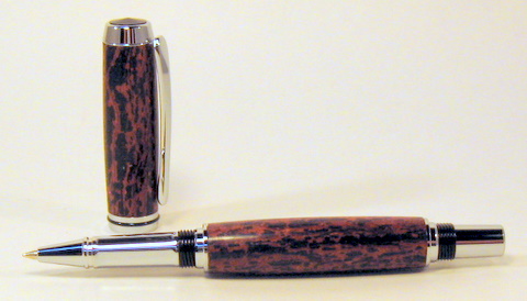

I received this blank in the last International Penswap from Fred Brunings (BigShed) along with two very nice Cigars in a wood case . One of them was made of this Red Ironbark . This blank is from the bark of the tree which can grow to 3-4 inches thick . It's pretty tricky to work with . I wanted to get a little more confident in my turning before turning this one . I chose a Chrome Baron RB to go with the blank . Thank you Fred and I hope you like it ! Thanks all for looking !

I really like the pattern of the wood. The finish is nice. If it is bark is it brittle or so thick that it is more like soft wood.
It's kind of soft , but it has tiny pockets , sort of like a sponge . I coated it with CA before drilling and three more times while turning . A slurry during sanding was necessary .

Great job on the ironbark Charles, looks fantastic. It is tricky isn't it? Doing some WW casting with it at present, will send you some when I am happy with it.
