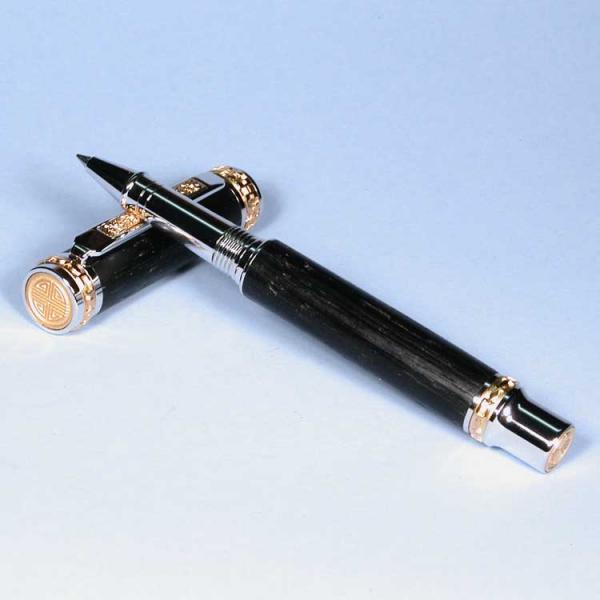

How is irish bog oak to turn it is on my list of woods to try
It's great, it's awesome, magical and enthralling, it can even look like this

Depending on the piece, it can be nearly as hard as Ebony, and takes a good polish, some of my pens are left unfinished and the natural oils from your fingers just make them pop like you wouldn't believe.
They are hard (harder than English Brown Oak which is what they started out life as) due to the soluble iron in the bog waters reacting with the tannin in the Oak. the iron takes up residence increasing the density of the wood and also causing the black staining.
The thicker the log, the more time it takes to turn the heart black, so you will come across pieces that are striped, or nearly all brown in the center. What has happened here is the irons are leached out of the water by the outer layers of the log, and the water in the heart is iron free. Given more time, the circulation of water through the bog would bring more iron to the heart, but it's an incredibly slow process.
There are bog woods from other places. I can get English Bog Oak which comes from the English Fens easily, and at about half the cost. I've seen the Danish Bog Oak on here before (not sure of the type of source, peat bogs like ireland, fens like England or some other condition). All are comparable in texture and workability, just different ethnic flavors. I even have a couple pieces of Bog Oak from a West Virginia Lake bed that has been dated by sediment layers to 10,000 years old that looks identical to the others.
The Irish stuff seems to command a higher price and have more of a following though. And as said above, is getting harder and harder to find in quality pieces. I can get pieces that need stabilizing all day, but solid to fairly solid that can be cut with minimal checks are getting hard.

Mike, any idea when you'll have some good IBO in stock, I may as well hoard some, I only have 2 pieces of the last batch I bought from you left. Your are right about it being better than the other Bog woods, that Emperor in my picture was out of some of the first i got from you a couple years ago. it's still one of my favorite pens. the last batch was harder than my Ex wife's heart, it hardly required any finish at all, but the one on the Emperor is kind of gnarly and open grain, it looks like it's several thousand years old.
