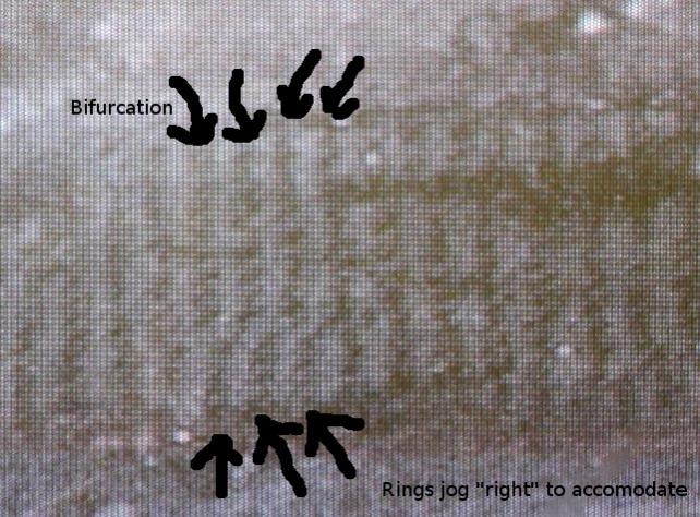

I made last night my first fountain pen and used Padauk. On close inspection today at work with higher power magnification loupe and microscope than I have at home, I can see a series of rings circling the wood. They look very much like finger print ridges as they periodically bifurcate and in both directions with and against the rotation on the lathe.
The sanding was done to 600 with cleaning between grits followed by CA/BLO. After each grit with the lathe on, I would wipe down and then run with the grain. I'm not seeing scratches running along the body nor do I see what I would consider a sanding scratch concentric to the body.
I'm pretty sure these aren't scratches, they just don't look like that, its almost like a growth ring pattern? Anybody else seen this in Padauk or other woods?
Image capture from screen. I've marked the bifurcating line, top left hand of the four with the other three showing the jog to accommodate the "new" line.

1) must be sapwood since I've never seen white Padauk (other than the sapwood). :tongue:
2) could it be your fingerprint that is now under your CA finish. If you touched the barrel before applying the CA for example. CA is known to raise fingerprints. You then coated the raised fingerprint with more CA encasing it under the finish. Just a hypothesis.

#1 don't trust the color. The screen capture seems to have shifted things to a lower contrast. The color of the pen in sunlight is correct for Padauk, a deep orangy-brown.
Not #2 as the rings are concentric along the length of the shaft (and I kept my grubby fingers off). The close-up just shows a very small section at about x14 magnification. I cherry-picked an area that had a clear bifurcation.

With enough magnification, even the smoothest and glossiest of surfaces will look like a dirt road.
Yeah, but it is fun to play with the microscope. From a hands-on, Mark-I eyeball standpoint it is just great. Its the engineer-geek that wants to know the why... :glasses-nerdy: Plus, as a byproduct of the way JPG compress works it shows up in high-contrast areas (reflections) when taking a photo. JPG compression has a tendency to emphasize "Mackie lines", those lines that appear when you have large contrast changes.

I'm pretty sure now that what I'm seeing are akin to medulliary rays. Looking at different parts of the wood and unfinished (but sanded) wood I can see the various patterns repeating. In some places they look like concentric rings, other places I see them diverge into rings and loops. Seems to be a correlation between the pattern the little rings make and the density of the wood.
None of these look like mechanical scratches or sanding marks.
Any way, it is was an interesting exercise to look closely at the wood structure.

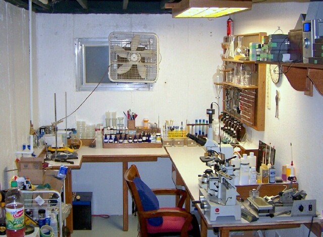

Sorry to be so geeky but wood anatomy and xylology are hobbies of mine.
Here's my basement lab. I call it "Wood Shop II" :

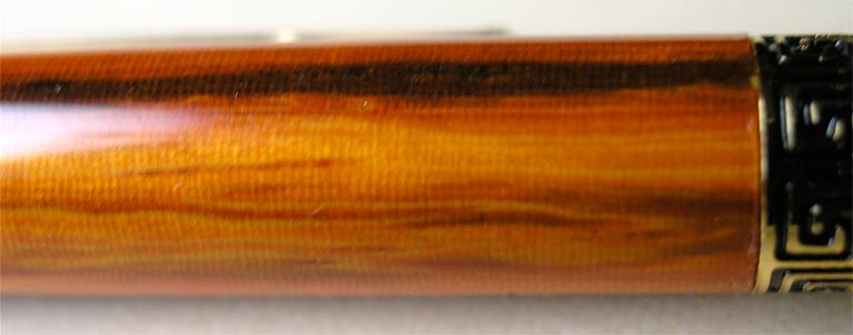

Here is a picture of the Padauk rings from the first pen that I made for me. It is not a clear pict but I didn't have a good digital camera back then.

Just to be sure they weren't there because of my sanding I turned all the finish off and started over. I was very careful to sand with the grain with each sheet of the Micro Mesh before going to the next one. When I got to about the 3600 or 4000 grit I started seeing the rings again. I went ahead and finished the pen and you cant see the rings unless you're looking for them.
LOL! :biggrin: I did the same thing! I saw the rings and then questioned myself if I had in fact sanded it properly. I didn't notice them at first - until after finishing. So, Like you, I turned it back down to the wood. AND that was on the pen in the picture above.
