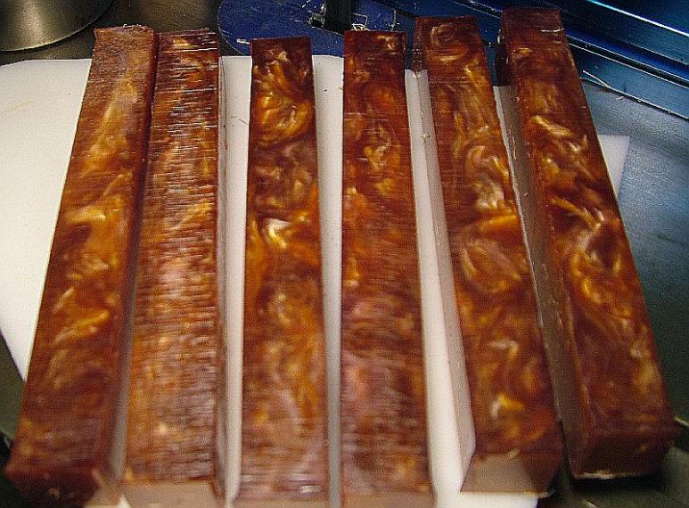

BTW .. I just tried the Alum dyes with PR. I mixed a bright tangerine
pearl with a deep royal purple and pearl. What I got was a sort of rust/gold
colored pearl. Very nice, don't get me wrong.. but the red and blue just
disappeared.. as did most of the orange.

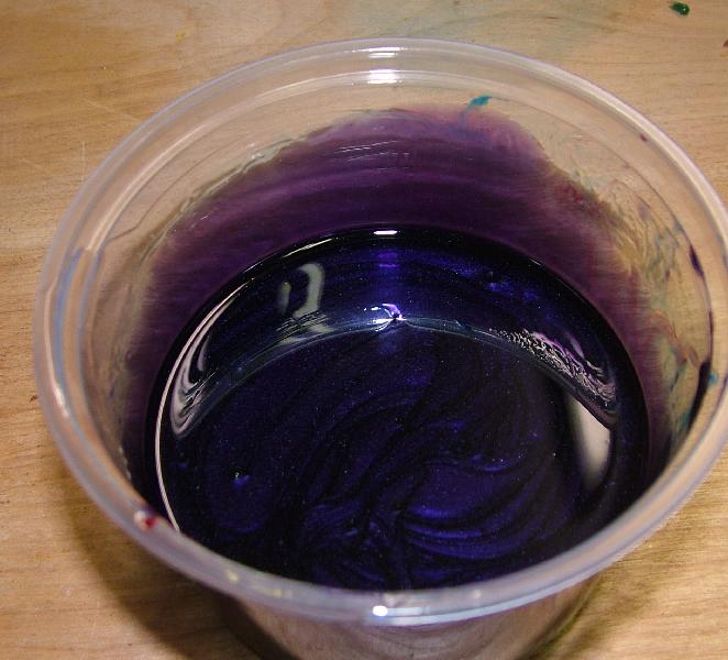

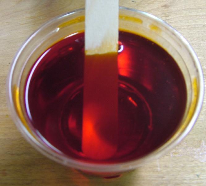

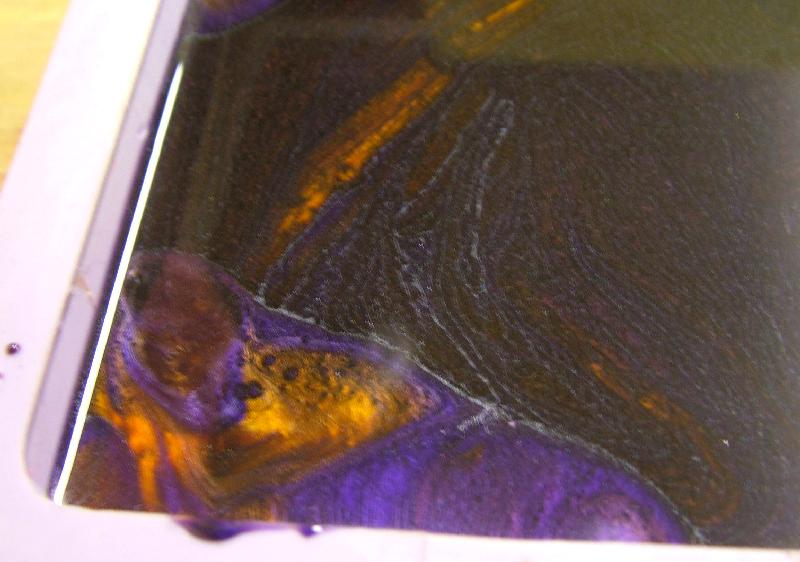

OK.. here's a couple of photos to show what I've run into.
This is PR with Alumilite dyes. I'd like to get some translucent
dyes with similar color saturation .. but all the PR dyes I've tried
seem to go cloudy or opaque when used in concentration.
The Alumilite dyes give me the colors I want, but bleach out
when used with PR. (the heat, maybe?)
You can see in the orange one that it is a deep color, but still
crystal clear all the way through. The purple is too, but there's
I mixed them in the mold ,stirred ,poked, etc. and everything looked great.
But when they were done, most of the color was gone.
Any ideas? I've gotten a few thoughts via PM ,and I thank you for
letting me pick your brains.

Charlie, thanks for the pics! It looks like the purple color all but disappeared with the Alumilite dyes..:confused::frown:
If I am reading correctly, you said that the transparent dyes from other sources were either too diluted (I hear ya) or turned the PR opaque (?).
First, this seems to be a consistent issue no matter the dye, so try using a different base. Maybe you happened to get an old or off batch of PR???:confused: If you want, I can send you some of the stuff that I use.
You could also try letting the other dyes become more concentrated. Simple evaporation will work. But unless you want a workshop that looks like it went though some sort of bad tie-dye experiment from Hell, becareful NOT to knock over the open containers...... DAMHIKT!! :rolleyes::rolleyes::rolleyes::rolleyes:
Yep .. and most of the orange, too. I wanted a really bright, vibrant
tangerine pearl, which I get before it cures. Wonderful colors.. and
the purple was a deep royal color, looked like velvet.. maybe a king's robe
or something the pope would wear. As you can see, the color didn't hold
up.
They give a tinge of color or they get milky. You can see from the orange
dye, that the color is deep, but still very clear. Some of the blanks I want
to do need this depth and clarity. For instance, if I mix part of it just
color and part of it color with pearl and then swirl the two, I get a deep
color, but a 3-D effect at the same time.
I need a dye that can give me a deep color, but I can still read through it.
The opaque PR dyes I have work fine (colors aren't great, but not terrible)
but to custom mix colors, I need translucent dyes that won't change
the opacity. The ones I get look like I'm seeing the suspended solids in
the dye.
This is many batches of Silmar 41 and Cast'n Craft. But it isn't the resin,
you can tell by looking at the dyes right in the bottle.. they're not clear.
Wait .. you mean .. there's workshops that DON'T look like this? :confused:
