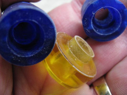

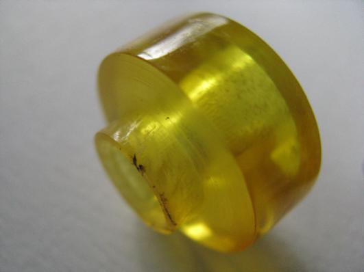

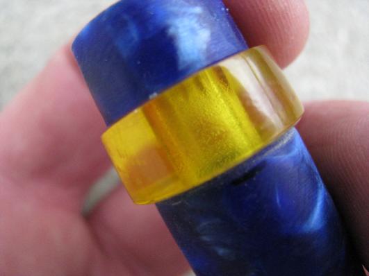

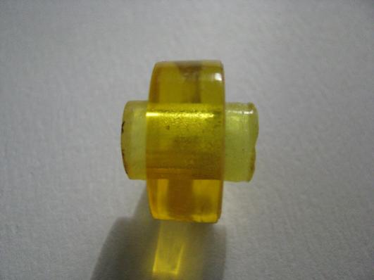

cowjelly Member Joined Apr 20, 2008 Messages 34 Location Jeffersonville, IN, USA. Nov 14, 2008 #4 Hi Hewunch, this is how I've figured it out. This one needs polishing on the inside. Then epoxy to hold it between the sections. I hope this helps. Thanks, Keith... P.S. - I've added with acrylic pics b4 glue up. I hope this helps. Attachments IMG_0389.jpg 15.2 KB · Views: 206 IMG_0390.jpg 13.6 KB · Views: 188 IMG_0394.jpg 22.8 KB · Views: 198 IMG_0393.jpg 19.4 KB · Views: 187 Last edited: Nov 14, 2008
