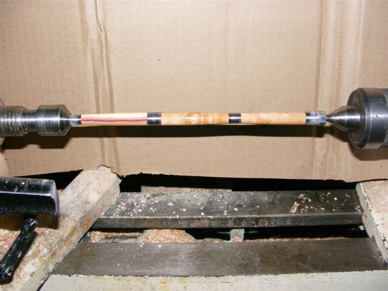

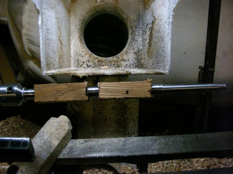

New 3 blank 7mm and sierra mandrels
I got these from JohnnyCNC before his accident and he will not be back in his shop until he is fully recovered. I am trying to speed up production with more pens with less turning and keeping the quality the same or better. With these two new setups they run so smooth and true and with the new universal mandrel from Lee Valley it could not be better. The bushings for the sierra mandrel are a little under sized to allow for the CA finish and they are GREAT. Made of tool steel they will out last the mild steel ones many times over.

Two words: Beall Collet.
Then, you can make your own mandrel that goes the length of your lathe bed and make five or six at the time. On a jet 1014VSI it cuts the turning time to almost 1/6th the time of turning one Sierra barrel. DAMHIKT:).
PenMan1
Jul 8, 2009
6,380
Eatonton, Georgia
Maybe I am missing something, but wouldnt a much longer mandrel rod cause a lot of whip and OOR blanks?
Not with a collet chuck. As long as you begin with a straight mandrel, the collet makes it difficult to bend the mandrel and put the whip in the blanks.
Additionallly, when I turn "6s", I push the lathe to top speed, further reducing turning time.
