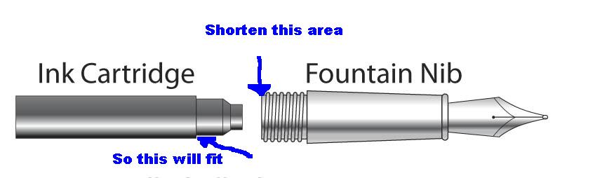

Jr Gent 2. Yep. Happens regularly. The converter just barely fits and/or comes off about the time you get things all screwed back together. More often with the Black Titanium than others. If one brand converter doesn't fit, none seem to fit.
My solution was to shorten (grind & polish) the metal a mm or so where the shoulder of the converter or cartridge comes into contact with the nib assembly.
Actually the metal extends past the end of the threads by a MM, more or less on the ones that have problems.
Substitute converter for cartridge shown in pic
