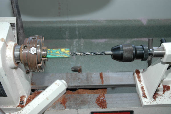

I don't drill on the lathe but I believe what others do is mount the pin jaws on your scroll chuck (the one you use for bowls) and mount the blank. Put your jacobs (drill) chuck in the tailstock and put the drill bit in it. Turn on the lathe and use the hand wheel to advance the drill bit into the blank.

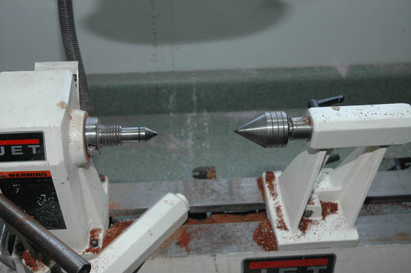

Here are a couple pictures of how I do it, hope they help.
The first shows the drilling
The second shows the 60* live and dead centers
The third shows the blank and bushings mounted

Thanks for the pics. They were just what the Dr. ordered. I actually have the accessories to drill with and gave it a shot. The jaws are round and hold a round blank well. Not so much with the square ones. I will have to get some different jaws I guess to do those.

Stephen , if the blanks you are trying to drill are perfectly square then the jaws shown will work fine but if the blanks are uneven or not perfectly square then you will have to either square them up or turn them round between centers like the ones shown in the second and third pictures first then drill them with the jaws you have . Just put a center mark on the ends of the blank ( I use one of those automatic center punches to make the mark (dimple)) then tighten the blank between the two centers , it may take a few turns of the handwheel on the tailstock until you get it tight enough for friction to keep it spinning while you turn it round .
