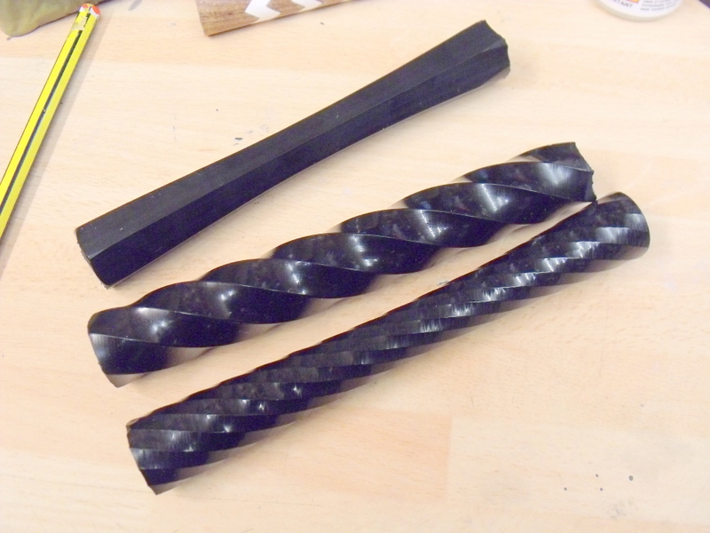

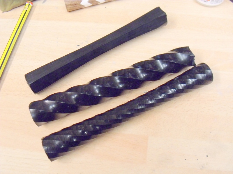

I recently showed a black 6 sided helix black, in a thread about metal lathes and how only a numpty would get a ML with a fixed gearbox......:tongue:
After that helix blank, I figured I could do a six sided centre taper blank ( to sort of match a Panache )

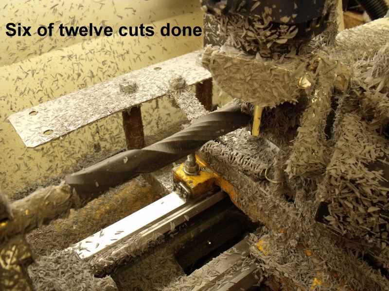

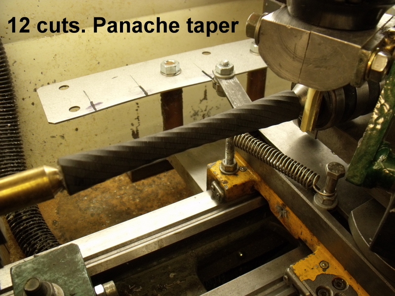

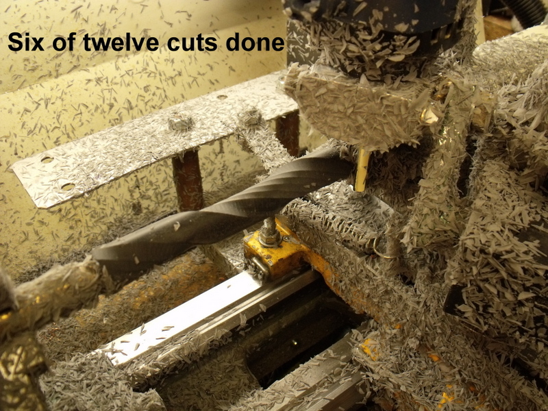

Then I figured I'd have a go at doing a 12 sided helix with a centre taper - also to match a Panache style pen.

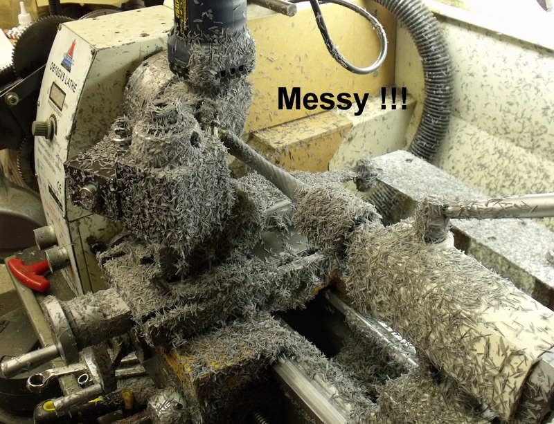

Well the good news is that my contraption and jigs work.
The bad news is that old habits die hard....

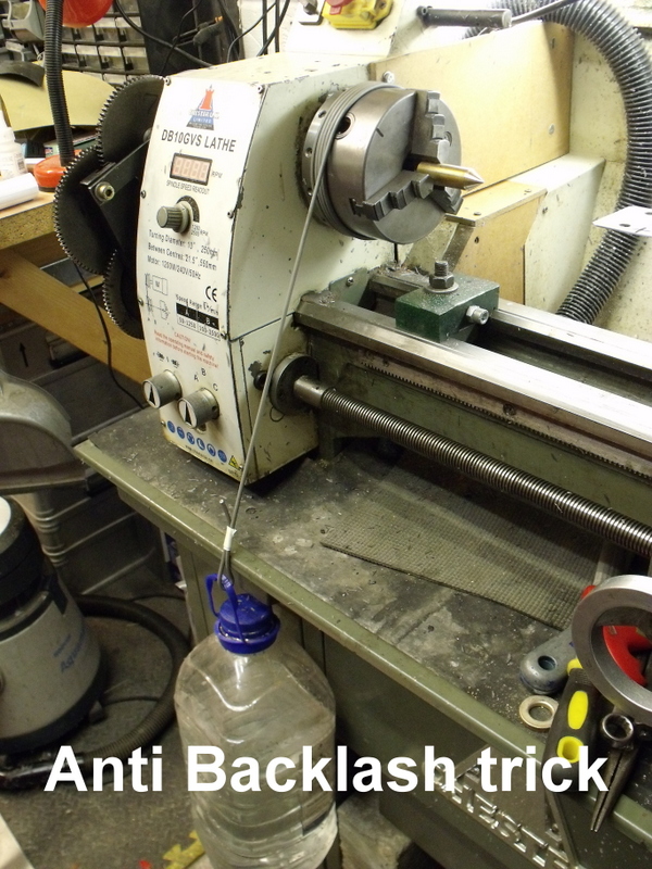

1st rule I forgot and often forget is the direction of cut when using a router. You should go against the rotation to get a decent cut.
Second thing I forgot is the famous backlash.
Router direction is easy.....instead of travelling from TS to HS, simply do it the other way round.

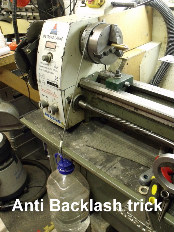

Backlash in the gear train is just as easy using a common trick. Just wind string with a weight around the chuck.:rolleyes:

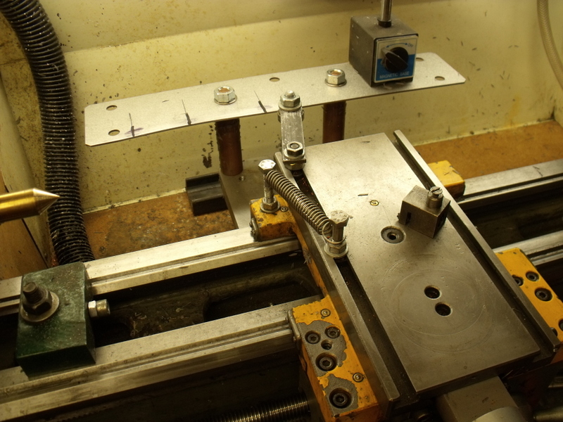

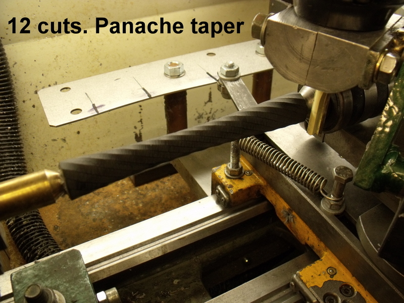

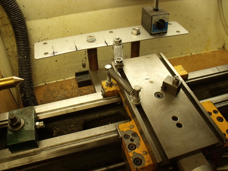

The pics actually sort of show how, but any guesses on how the centre tapers were done? :biggrin:

Beats me but it looks amazing! Is the spring a clue? Does it keep the router tensioned against the blank?
I'm assuming the speed of the carriage travel is slow enough to give you plenty of time to turn the router off when you get the end of the cut so you don't hit your centre!

The back plate is the template for the profile of the blank. It sort of looks straight in the pictures but its not. The arm and bolt act as the follower and the spring keeps tension on it.

Like Mike said. You made a tracer for your cross slide. Now you can make most anything with a shape from taper to wobble'dee'gobble. :rolleyes: How easy is it to disconnect your cross slide from its screw? And have you tried the setup cutting metal yet?

I knew you would get it Mike....:wink::biggrin:
The bolt actually has a ballbearing in it.
Of course, the cross slide split nut, under the table needs to be removed.

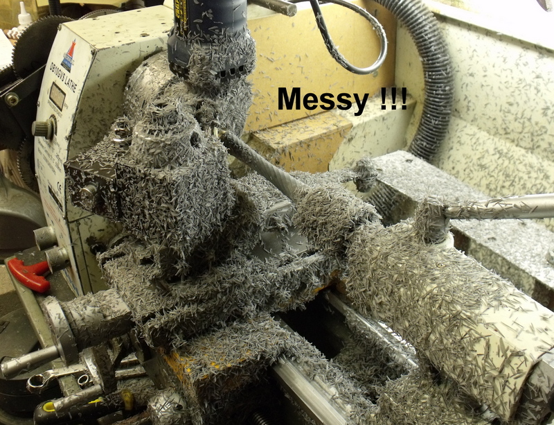

Anybody who messes around like me... PLEASE NOTE the lathe is NEVER on when I have my router mounted. :wink:
The lathe merely acts as an indexable spindle and I use the rest of the lathe features like the bed and cross slide etc just to get repeatable accuracy.

Curly - Pete,
To cut metal I would simply swap the router for a small grinder. Several of my early pens were done like that with a wood lathe and a compound table mounted over the bed. :wink:
oh...nearly forgot... Taking the nut off is pretty quick as I have extended the depth of my back splash. This means I can wind the cross slide bed right off. One screw in the middle of the bed.

Fascinating, Skip !!!!! . Would you have a picture showing how the router is mounted on the cross-slide, please ? . If not, don't worry about it.

Thanks, Lin ! I am wondering now what kind of router Steve uses ... doesn't look like your standard Makita router for cutting channels in wood or rounding edges.

This link will take you to a thread where I showed several of my bits and bobs for my lathe. I could probably update it now with some more refined bits.
Try this link
The little router I use is a trim router. It is supposed to be for trimming laminate etc but I have done away with the base.
The mounting collar I made also matches my drilling machine. The collar size is a standard in Europe.
