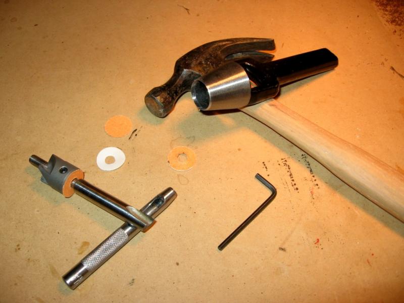

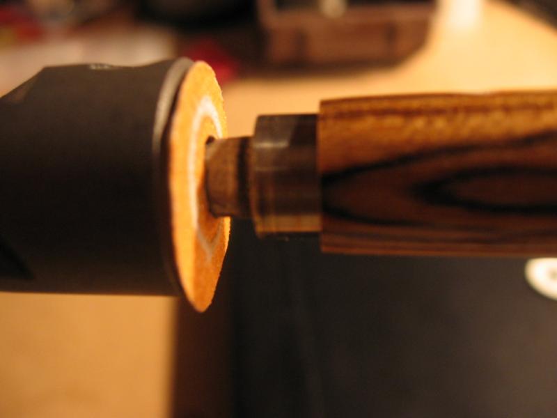

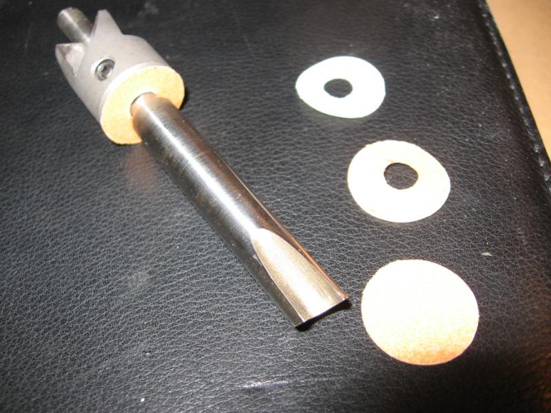

For all of you who have a barrel trimmer and are concerned with cracking, tearing off chunks or getting the end of a finished blank absolutely square, here's an idea to try. I looked at all of the trimmers and sanders and decided I could save some money by using my barrel trimmer as a sander. Here are a couple of pictures to show what I did. I used a 3/4" punch, a 1/4" punch, a piece of MDF to hammer on, a hammer (duh), and a 5" 220 grit PSA sanding disc. I can get from 25 to 30 sanding discs from one 5" disc. Just chuck it in a drill (or the lathe) and slide the finished pen barrel on it and sand it square and flat. HTHS

Word of advice for everyone that shaft comes through the blank and can make a hole in one hand real quick. My solution was to cut that shaft off enough to nest inside the blank and furthermore to just use two punches to create the adhesive backed disks then use the existingflat round metal as the backing plate the same way.
