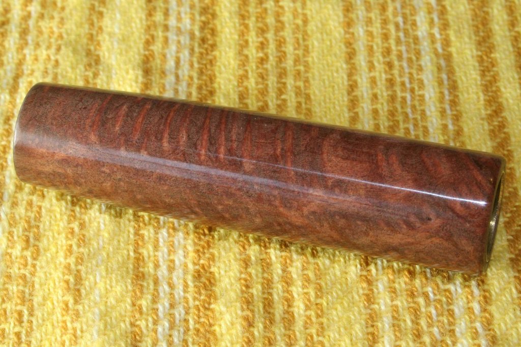

It's been a few years since I turned any pens. I've been back at it for a few weeks and I now remember some of why I ended up putting the hobby away for so long.
I'm terrible at finishing.
This is so frustrating for me because I've spent hours upon hours reading about different techniques and hours upon more hours out in the shop trying, retrying, testing, and refining and I don't feel like I'm any better now than I was when I first got started.
Out of everything I've tried, I've had the best results using Les Elm's wipe on poly technique. It was time consuming, and I never really got the hang of it. I often burned through the finish while using the micro mesh. I liked not finishing with the bushings installed and I was always pleased with the results when I managed to get through the process without screwing up. Because of the time involved, I started looking at other options.
The next best results came from Enduro. It wasn't as time consuming as the wipe-on poly and the results were almost as good for me, but I never really got the hang of it either. I used to get it from Ernie at Bear Tooth Woods and used his instructions. It worked pretty well, but finishing on the lathe with the bushings installed sucked. It sounds like this pretty much got replaced with Wood Turners Finish anyway.
I experimented for a good while with CA. I really disliked just about everything to do with it. From the fumes, to the finish sticking to the bushings, the blushing, the cracking, the mess, the plastic look, etc. Maybe I'm just a clumsy, fat fingered, doofus, but I had nothing but trouble and finally just gave up. I don't really fancy giving it another shot.
Most recently, I started working with Wood Turners Finish. I read a bunch about it, watched the videos by General Finishes and Ed Brown, and went to it. It reminds me a lot of Enduro. I've had trouble getting it to build up and would routinely go right through it with micro mesh. I also had trouble with those dang bushings like Enduro and CA. Otherwise, it wasn't too bad.
I'm considering continuing experimenting with Wood Turners Finish, but I'm also interested in trying Les Elm's Poly Dipping method.
Overall I'd say I'm just really frustrated. I'd love nothing more than to start getting some consistent positive results. I don't expect my finishes to be show quality day one, but I do want to be able to give someone a pen without being embarrassed about the finish.
Any advice or constructive criticism would be greatly appreciated.
Thanks!
Edit: It just dawned on me that I've never tried spraying/air-brushing. I don't have the equipment, but I wouldn't be opposed to giving it a shot.
Paul; I had a terrible time with CA, but now I can finish a pen in about 20 minutes. I still wait and let the CA cure overnight. Leave CA finished pen in the open for several days to allow the CA to "outgas". Don't cap the pen.
With oily woods, wipe the blank with denatured alcohol before applying CA.
Start with thin CA. Apply about 5 coats. Done. No sanding.
I have a set of cone bushings made of delrin that I use for CA finishing. Wax the cones and your mandrel to keep the CA from bonding pieces you don't want bonded! DAMHIKT!
I don't like the "plastic" look and feel on a fine wood surface either. I just hit the blank with 0000 steel wool as a final step. It gives a nice satin finish to the blank, and the feel is more like wood. The CA still protects the surface from skin oils and dirt, but the pen looks fantastic and appears to have no finish at all!

Thanks for all the replies. I appreciate all the CA tips, but that just isn't a direction I'm ready to head back down just yet.
I really feel like I'm missing something very basic and trial and error isn't getting me any farther down the road.
Let me run through what I did on this last pen and see if y'all can spot what I'm doing wrong.
  1. I turned a cigar pen between centers using JohnnyCNC's bushings. The barrels looked beautiful.
  2. I sanded through 150,240,320,400, and 600 grit cloth-backed sandpaper at 1240 rpm, first with the lathe on and then with the lathe off going lengthwise.
  3. I went through all MM grits with the lathe at 1240 rpm. The barrels looked pretty good. I didn't notice any scratches, so I thought it was okay to move forward with finishing.
  4. I took the blanks off the steel bushings and put them back on the lathe with no bushings, bringing the tail stock in just snug enough between the brass tubes to allow the dead center to spin the blank.
  5. I took a viva select-a-size paper towel and quartered it. Then took one of the pieces and folded into thirds. I used this to apply the finish.
  6. I applied a generous amount of WTF on the paper towel, enough to saturate it.
  7. With the lathe at 1240 rpm, I applied one coat going back and fourth a couple of times.
  8. I applied another coat every 1m for 10m for a total of 10 coats.
  9. I left the barrels overnight.
  10. I gave it a quick very light once over with 600 grit sandpaper to even it out.
  11. I went through the same finishing process for another 10 coats and left it overnight.
  12. The finish at that point looked pretty good, but had a couple problems.
    • There were humps of finish at the ends of the blanks that needed to be leveled off.
    • There were surface imperfections and unevenness.
  13. I quickly and lightly used 600 grit paper to even things out.
  14. I then went back through the MM grits. Once done, it was clear there was still sanding marks.
  15. Thinking I wasn't using enough pressure, I went back through the MM grits again a tiny bit more agressive.
  16. The sanding marks were pretty much gone, but the blank was splotchy and dull where the different areas of grain were. Kinda looked like the wood soaked up the finish more in certain areas.
  17. At that point, I realized the finish was gone and I was back to bare wood. So I went through 20 coats and didn't even realize it.
So, some basic questions.
  1. What lathe speed should I be using?
  2. Am I sanding too much? Not enough? Too lightly? Too heavily?
  3. Am I not putting enough finish on the paper towel?
  4. How often should I reload the paper towel?
  5. Should I use something other than a paper towel?
  6. Am I not waiting long enough between coats?
  7. Am I going back and forth too many times?
  8. Am I applying too much pressure while finishing?
  9. Should I be sanding between coats?
I've done every variation of these I can think of, but I'm having trouble even figuring out what's working and what's not.
Finishing is what made me quit turning a few years ago. I really want to figure out what I'm doing wrong because I love the turning part.

Some thoughts...
Thin CA for the first coat to "seal" stuff off.
Med CA after that to build.
Speed is variable since Joe A uses 800 and Joe Z uses 3200...find what you like.
You are going to have some ridges.
You have a good 5-8 seconds with paper towel to work each coat.
You will sand some off.
Try building 10 coats of medium and a quick wet-sand and see what you get.
Try what everyone else says first!
Stay safe and blessed!

It sounds like one of your problems is sanding through the finish with the micro mesh.
I've done the same thing and adjusted my process. The blank should be smooth before you use the micro mesh. It's just a polishing step.
Two things that work for me:
1. Light pressure. If you press too hard you will burn through the thin layers of finish, no matter what you used.
2. Time. If you apply the pad too long, you will still burn though even with light pressure. Count to 3 and then move on to the next pad and they must be wet.

I did some more experimenting and I think I have finally made some progress toward my goal! The things I did differently that seemed to make the biggest difference were to:
  1. slowed the lathe down to 840rpm
  2. ensured 1500 grit micro mesh took down all the high spots and left no shiny areas (huge improvement here)
  3. sped the lathe back up to 1240rpm
  4. wet sanded with all micro mesh grits while wiping down with a cloth between grits
I did put some renaissance wax on, but I think I need some kind of polish first. It's still not as clear as I'd like it.
So here's a sample of where I'm at right now with working toward a high gloss finish using Wood Turner's finish.
By the way... somebody gave me those blanks and I have no idea what it is. Anybody recognize it?

OH yes that's not bad actually. There does appear to be some low spots still on the right end of the image.
Few things for you to try that should help greatly.
1) since this is shiny, hit it with 800 - 1500 grit paper on slow speed with a super super super light touch. You want that light touch to be even and fluid all across the tube. Paper the width of your finger helps with this. Put your finger on the opposite side of the tube from where the sandpaper is working on the blank. If you feel grains like sand, rice or what not then you need to stop and clean the blank, move the paper more frequently.
2) STOP, yes that is S T O P *IMMEDIATELY* when you see the shine is removed.
3) Put a light on the right edge of the image.
4) stand on the LEFT side of the image.
5) look to the RIGHT side of the image and what you are looking for is shiny spots.
6) slowly rotate the blank and observe where the shiny spots are. <- These are low areas in the blank. they will appear as dips and pockmarks all over the blank when finished.
If you do see shiny areas then you have 3 options here:
1) Ignore it and finish it out
2) sand until there is no shiny spots
3) add another CA coat and said that one smooth.
Also it appears there is some banding going on which is scrape marks from sanding. If you have a 10x or 16x loupe that will play handy here. You can see the scratch marks and know how much you need to sand, or build up.
Another solution that may have been missed, overlooked or not even discussed is a CA satin finish :)
*) Turn OFF the lathe
*) Take something like 2,500 grit, super super super fine like that.
*) Rub left to right on the lathe with an ever so light stroke, just enough to break the shine.
*) wipe the blank down constantly. you want NO buildup of dust here.
*) repeat the entire blank
*) turn the lathe on the lowest speed possible
*) you want to use your bare skin, CLEAN, to every so softly graze the surface. LIGHT touches and run over the blank entirely. As you look at the blank you will see a shift in the hue. it will go from dull and get more shiny. The instant it goes from dull to non-dull you want to stop.
Reflection is an art form. For something to be shiny all of the grain patterns need to be lined up in a row. For satin you want the same lines going in various directions. As light hits the object and bounces the light will 'group' in one direction and cause a glare. Bouncing in multiple directions does not cause a glare, well not as much anyways.
Clarity comes from several issues. How smooth the clear material is, i.e. lumpy, inconsistent, etc. Scratch patterns and believe it or not the direction of the material grain vs the lines on the polish. Parallel lines makes things more fuzzy.
