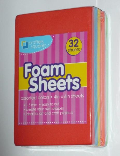

I love this stuff. I just got some foam sheets, did one pen, and fell in love with it. Beats paper towels without a doubt.
Here is a picture. Check this "buy it now" item on eBay, 350551212829. It is $4.49 for 32 sheets shipped. (I hope it is OK to post this, I have no connection to the seller.)
could someone post a picture of the foam so Idont come home with a box of the wrong stuff thanks Jeff
