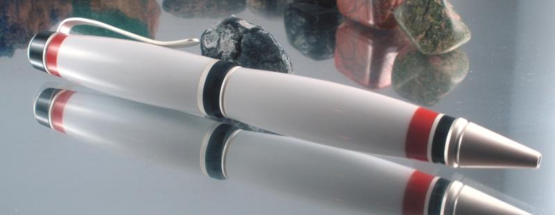

Dawn's white polyresin
Here is a pic of a pen I made a good while ago using the regular white polyresin blank for Dawn. It's on a satin silver cigar kit, with some red accent rings. Pen is long gone but I still have the pic. It's really white.
