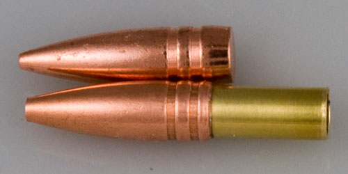

They do work well when you want to solder a tube to the bullet. You can even cut a stepped tenon on the base.
Here is a picture that almost shows what I mean. On the top is an unmodified TSX bullet. Below is one that is drilled out for a mini-refill and has a stepped tenon cut on the base. The first step matches the inside diameter of the brass tube, so the two mate squarely. The very end of the base is stepped down a little more, such that a ring of wire solder fits between the bullet and the tube. I pressed everything together and heated it up to attach them permanently.
This is the first step of making a 308 Win cartridge keychain pen like I've posted previously.
Regards,
Eric
