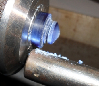

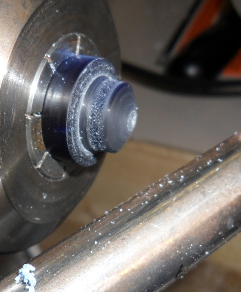

Here are a few pics showing basically how I do it. I first use a parting tool to get close to the final diameter. The I use a spindle gouge to shape the piece. Then just part it off. If using a skew, I usually finish the parting with a hack saw. With the lathe running, just rest the saw blade in the groove, and let the lathe do the work. I used a 1/2" spindle gouge, a regular parting tool, and a skew to do the work shown. When doing the cap contour, I work from the outside to the center. And if I was going to use this piece, I'd polish it before parting it. Hope this helps. And I'm certainly no expert, so if anyone has some better tips, feel free to chime in.

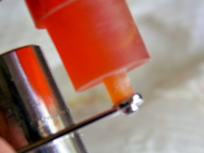

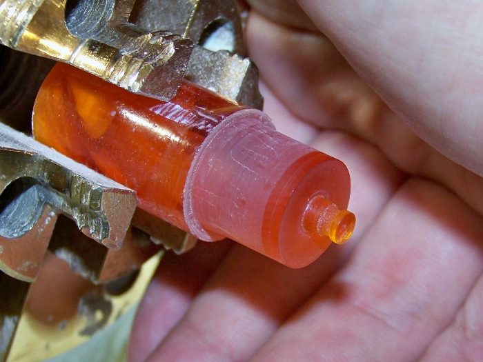

Looks great Bob. I really like the mods. I don't want to take away from your work, but I took some pics of turning a clip accent. They might help everyone with that part. One tip is to put a taper on the backside so it looks just like a cut stone. That way it won't want to flip on you when you try to glue it in (i recommend epoxy). Also it's good to sand and polish the back, especially if its a see through material. I also included a good way to check fit. Nothing is better than calipers, but its a quick test fit.
That's about how I did the clip insert, but I didn't have that much material exposed. It worked fine doing the taper like you suggested to me. My problem came doing the other side of the insert. I basically ended up shaping it by hand (after it was glued into the clip) with basically a small sanding tool I had for doing wooden models. But a fingernail file would probably work just as well. I just had to be careful not to scratch up the clip. Polishing was pretty easy once I had the shape I wanted. I just held the clip & did figure 8's over MM through all the grits. It probably took a little longer than doing a pen barrel, but the results were comparable. All in all, it was a fun pen to make, and I learned a lot.
