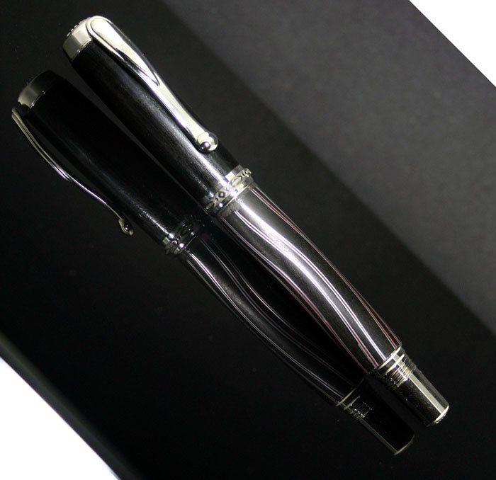

Ebonite, ebony and aluminum

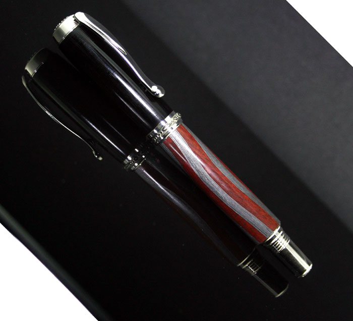

Ebonite, bloodwood and aluminum
Thanks to all who look and particularly those who comment. [8D]

I can see his handiwork, and yours too! Great combination of workers and great work! I REALLY like the color combinations on the bottom! the layers of aluminum look like silver threads in the picture! Majestic!

Really like the color contrast on the nib holding section of the aluminum and bloodwood. While I'm a big fan of mixed materials, for me, I'm not sure the ebonite works with these. Maybe its the photos.
For the top one, it looks like one of the waves doesn't make it to the top - intentional or optical illusion?

Well done, both of you. I think I prefer the bottom one but only because the 'spot' near the cb. I hope it is only a photo trick. But if it is a small flaw, is there enough length in the barrel to trim it a tad?
I would love to know how the aluminium was done on the bottom one too. Looks great. Please give the man my regards.

Nice collaboration, Lou!! Count me as liking having the cap and nib blanks different. It avoids the problem of lining up the wave pattern and makes the pattern less overpowering. I feel your choice of blanks gives the pens a more subtle dignified appearance.

They're both real fine pens.
What is the story on the nib end of the pen in the first picture -- is that wax that didn't get buffed off?

Thank you for the kind words and comments. There is a flaw in the ebony pen, primarily due to my drilling, I think. The cloud is actually a smudge that I neglected to clean up. I will try to post a photo with a lighter backgroud later.

With the black cap, could you get away with putting a red inlace on each end of the pen to eliminate the section that has the slight imperfection? If you choose to do this, mount a washer (Preferably CA-resistant material) next to the bushing (touching the brass tube). Then, turn off the "bad" section, down to the brass. Fill with inlace and CA.
While I am pretty confident you have done this before and did NOT need this detail, I hope it may help others who have encountered the "end of the pen" problems. I use it (as one method) whenever I get chips in polyresins at the ends. I DO, generally, use the same technique at BOTH ends, even if only one end is "damaged". I think it makes the pen look more "planned" than the "one-end repair" that screams "OOOOOPPPPPSSSSS"!!![:D][:D][:D]

Thanks for the additional replies. Thanks for the ideas on fixing the ebony one, Ed. I don't do much in the way of oops fixes, but I might on this one...although I like the homely mutt aspect of it. [8D]

I really like Eagle's metal and wood combo blanks. After seeing yours, I cannot wait till Ed gets a chance to turn his. At first I was not sure, but now I like the bloodwood one the best. Very masculine with the addition of the ebonite cap. [8D][8D]

Lou made an OOPS?????????????? I'm not sure my heart can take it.[:D] I like the bloodwood one better, but they are both beautiful as usual. Great blanks from the master as always.
