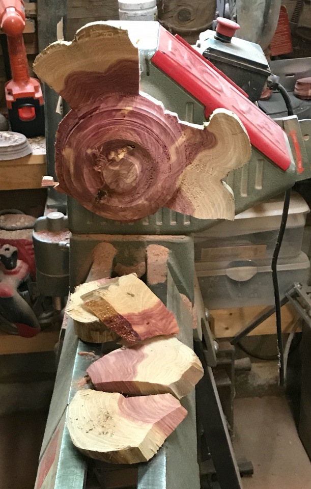

For Halloween, I decided to try something really scary. I wanted to turn an end grain piece with very irregular sides. The piece of cedar that I decided to try it on had some cracks running through it and exploded just when I thought that I was going to pull this stunt off. Well it scared the you know what out of me. I had to change my pants. My wife says that I have to do my own laundry today. She is just not very understanding.

I love working with cedar, but I stay away from big pieces & especially irregular stuff just for that very reason. Glad you weren't injured when it exploded.
That would surely have made a beautiful piece if it had stayed together.

Those are some big pieces that came off. I'm glad the only other thing that was damaged is your pants!
Whenever I see questionable cracks in large pieces I fill them with CA before I start turning. Sometimes I get past the CA fill and the crack is still there. More CA. Repeat. I don't like UFO's in my shop.
One thing I like about my new PM3520B is the safety cage. I know many Turners remove it and never use it. I keep it handy and use it on questionable pieces. Fortunately it hasn't been crash tested yet.
