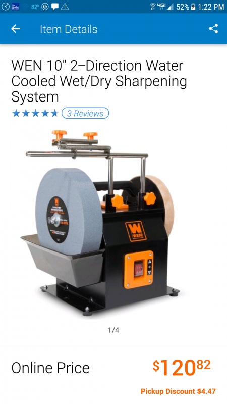

Firebucket53
Apr 19, 2017
23
South Carolina
Walmart online
Found this at Walmart online.
