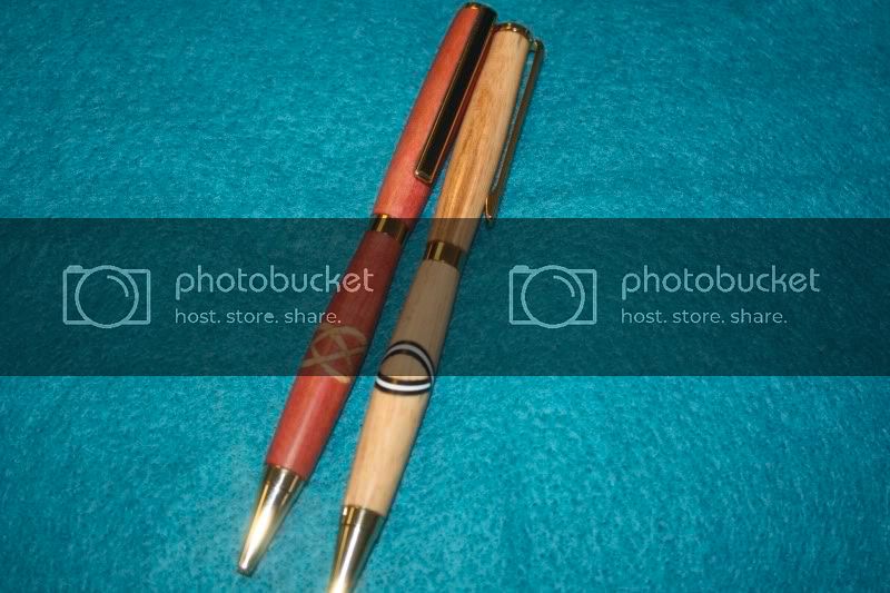

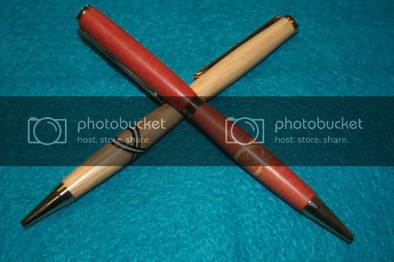

Yes I understand what your saying. I was able to get two good one's out of oh I lost count on the bad one's. I did one by cutting the blank all the way and glueing some pick guard BWB in I only did two lines. Then I did a knot with wood. And was able to cut some thin strips on the band saw to match the kerf. I did not cut that one all the way through. Then last night I tried again and was way off. But I think I have the idea now I will keep trying. What I would like to be able to do is make one and get the knot right even time. The tip on running a line from the center of the x to the top seems to work as long as the top and bottom are cut straight. I will try to post some pics this evening.
Chris88
May 27, 2009
112
Louisiana
Here are the two that I was able to get done.
