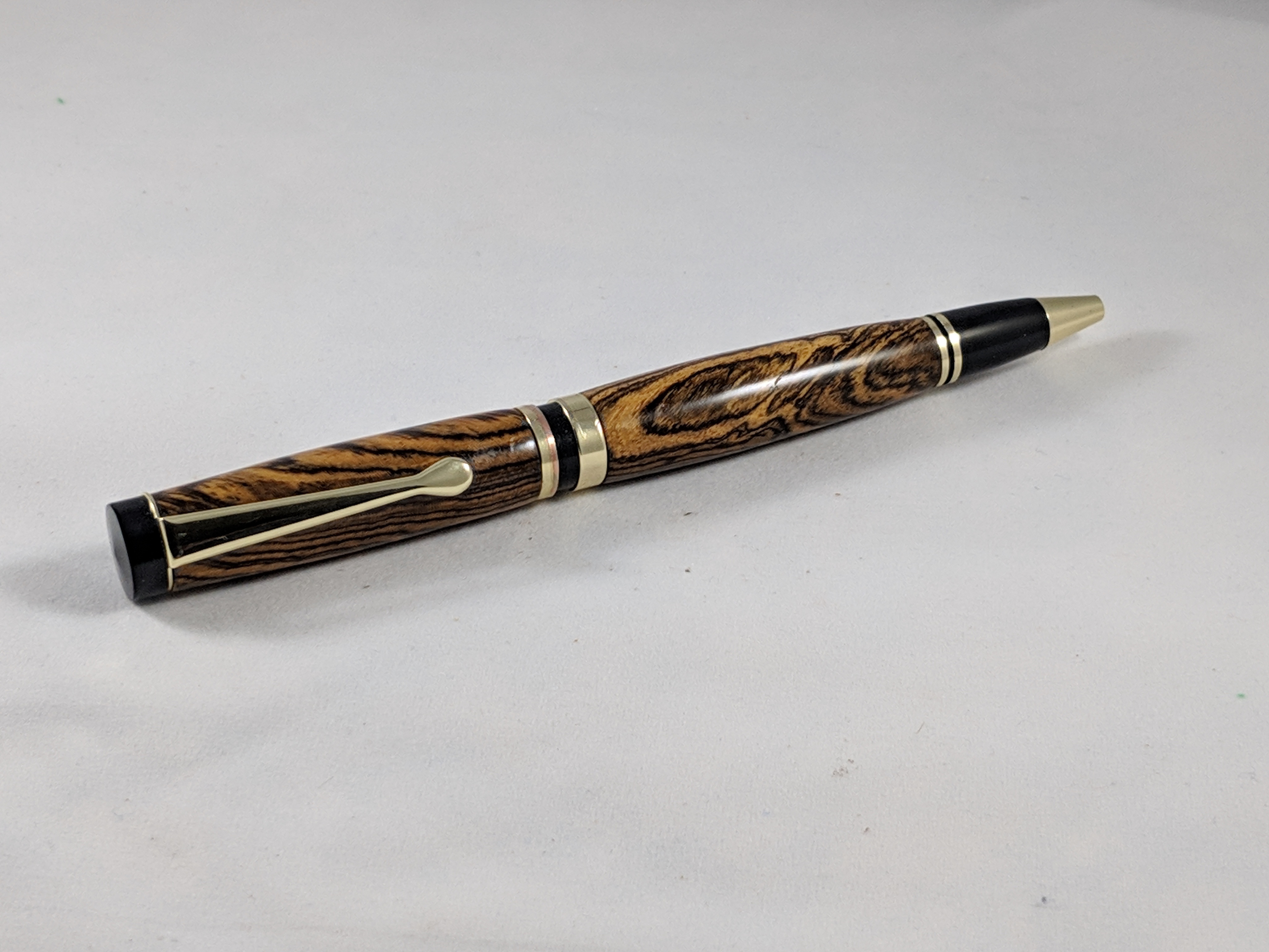

The bottom picture, is that a Classic pen kit? If so, how was the transmission on it. I've made two Classics now and both have had really rough transmissions that require I pull them out, soak in acetone and then put a drop of WD40 in them to smooth the transmission. You experience any problems?

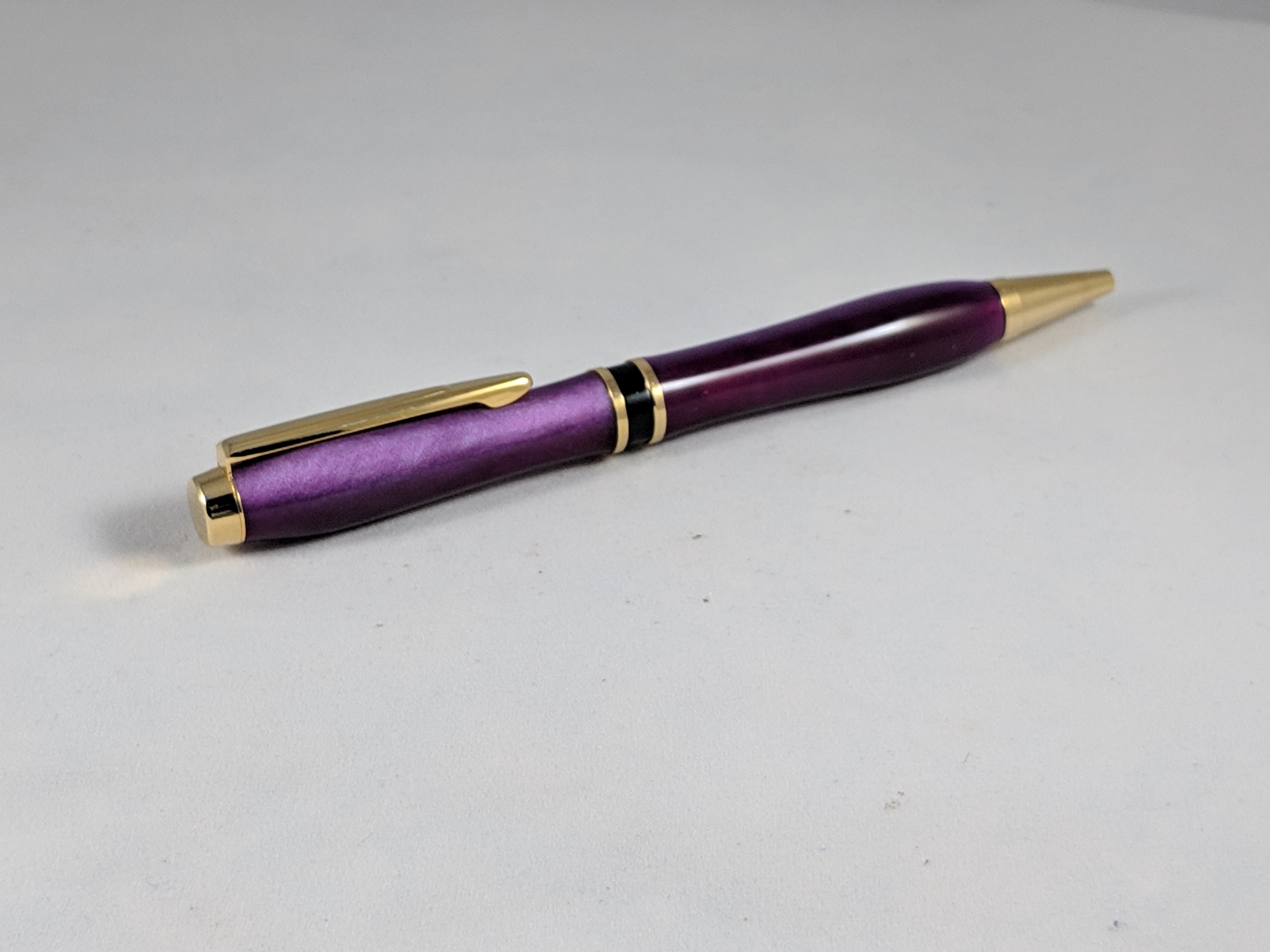

Pen 2, The Transition at the Nib and Clip ends look fine, though the Center Band looks good on the Lower Blank, but appears too low on the Upper Blank.

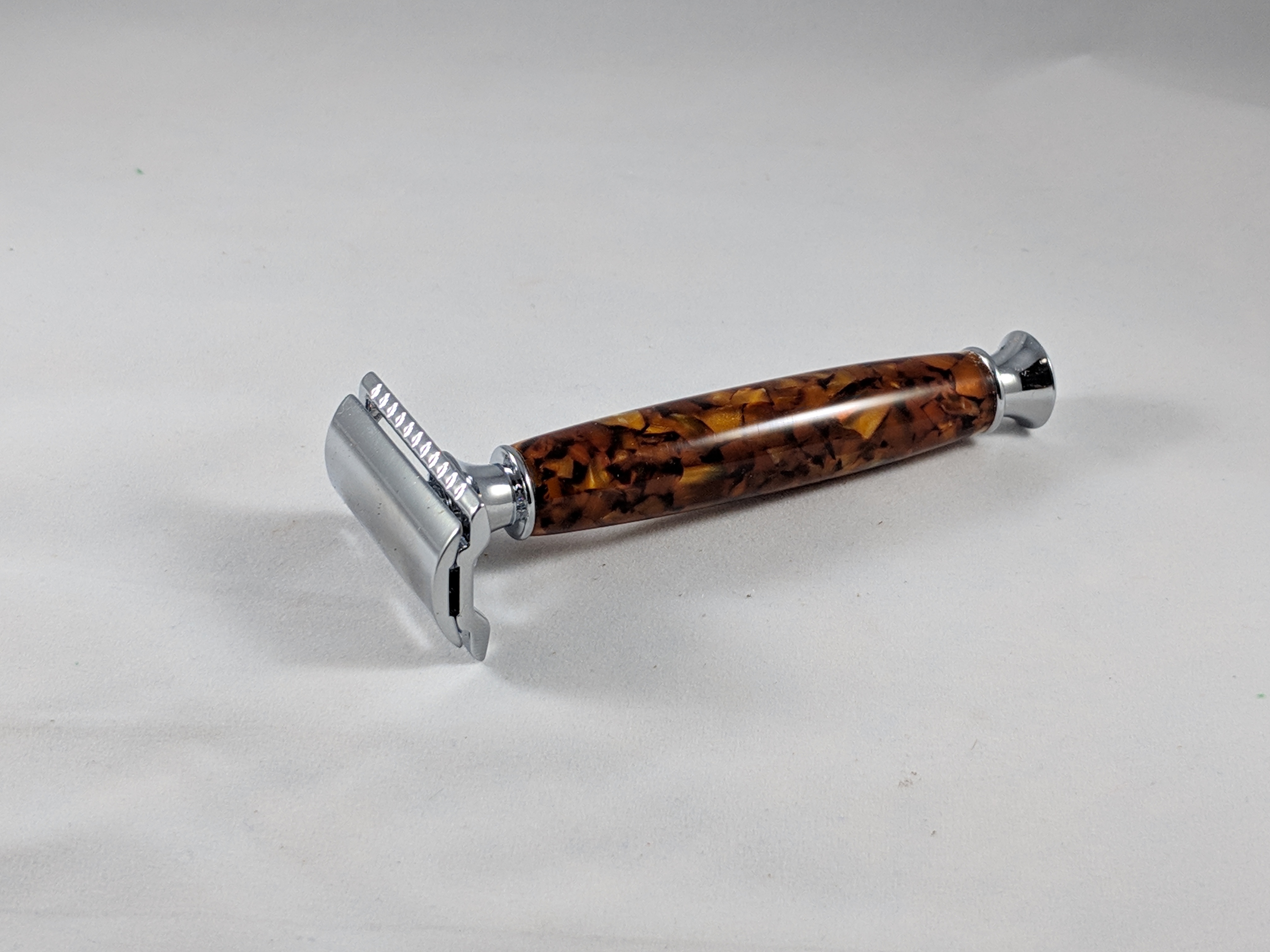

Razor, The Transition at the Blade end, looks reasonable, though the angle of the Photograph, doesn't show enough. The Handle End, with the angle shows quite a Furry edge with something sticking up.
The Final Pen looks very good, only a small gap on the Center Band Transition.

I appreciate the honest critiques. It lets me know what I've done well, and what I need to focus on. I appreciate the positive along with the areas where I need improvement, after all I've only been at this less than two months. Thank you.
