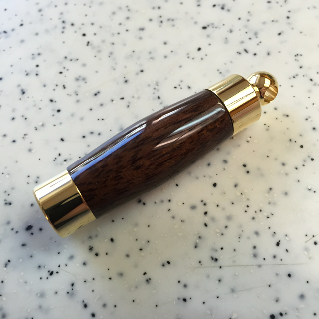

Warren White
Aug 27, 2014
497
Livermore, CA
You can teach an old dog new tricks!!
Just turned a CSI Perfume Holder (which for my purposes is used for Consecrated Oil) using the suggestions above.
That is, one drop of CA glue, applied center-to-outside, instead of the 3/8" worth across the paper towel that I had been gobbing on. It of course took more 'coats' than I was using before (I put about 12 light coats on), but it turned out perfect!
The bushings still required a light touch with the jeweler's screwdriver, but they separated without complaint.
