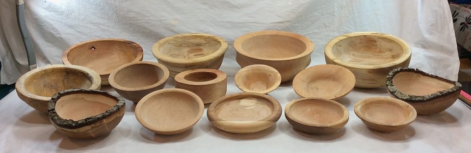

Rough turning bowls that is! :biggrin:
Recently, I roughed out some more of the bowl blanks that had been accumulating in the shop. A few of these have been done for a while and ready to finish turn now.
Most are cherry with some ambrosia maple and a spalted maple.
These range from 7" to 14" in diameter. I used Anchorseal on the outside and top of the rim as these are the primary crack zones and then placed them in paper bags while they dry.

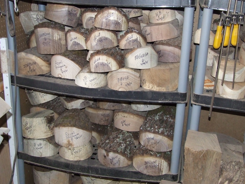

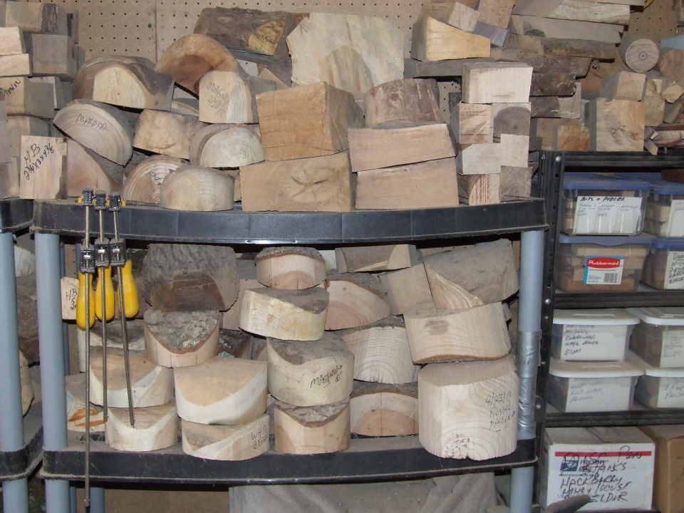

That is something I need to get up off my butt and get started... I cut a few bowl blanks last week and stacked them, but haven't started turning them yet...
Not all the blanks are from last week, some were done months ago and still not turned.

I'm trying to get and keep things off the floor so I have room to walk... the week before I got all those cut, I had half a tree split and stacked in the middle of the shop while I waited for new blades for the band saw... about a foot wide path from the door to the work bench and another foot over to the lathe. usually there's a pile in front of the racks too.
