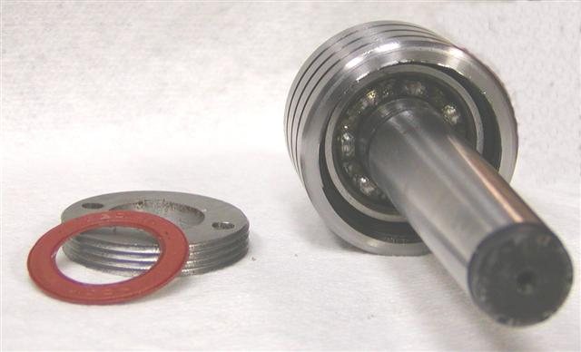

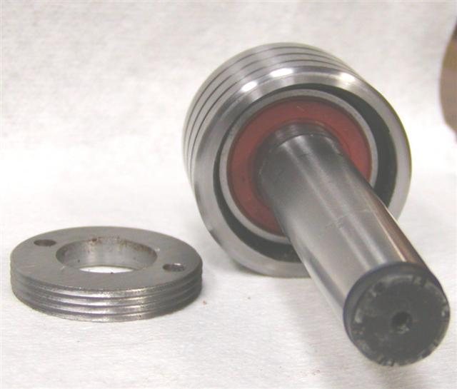

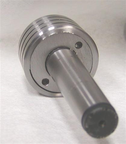

Tom: Thanks for posting those pictures. They were very informative. Kinda looks like that LC needs a little more grease??[:D]
Oh yeah.......and thanks for sizing the pictures to fit the format of this board. I don't know about others;but for my computer, the 640 pixel wide picture is a perfect fit!![^]
tas2181
Feb 10, 2006
151
Wisconsin Rapids, WI, USA.
Randy,
You are very welcome. The picture doesn't show the grease very well but I may just put in some more anyway.[;)]
As for resizing the pictures I downloaded the Image Resizer from Microsoft Powertoys. It works great. All you have to do is right click on a pic and choose Resize and it will resize to the resolution you want and it will make a copy with (small) (medium) (large) in the name. You have to get rid of the parantheses to post. ( The ones above are resized to small.)

I don't know about the more recent versions of Windows; but I can resize pictures in "PAINT" just fine without having to resort to a special program.
Question.....does the PSI LC come with any instructions or recommendations about a time interval for repacking the bearing?
And for whoever had the problem with the disk coming unscrewed, a drop of Loctite (blue) should solve that problem. Probably a dab of any type of glue would solve the problem.....wood glue, polyurethane or even the tinyiest dab of CA??
tas2181
Feb 10, 2006
151
The LC didn't come with any instructions or recommendations. There is nothing on the PSI website either. Don't know what kind of grease is in there. Seems to be a pretty light/ clear grease about the consistency of vaseline. Any recommendations?
Once I tightened the screw on cover with the snap ring pliers, I didn't have a problem with it coming loose. It seemed just to come loose from the enertia of the rotation when I first used it. Probably just wasn't tightened enough.
