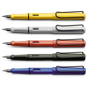

Who makes Lamy Safari?
Ray
Lamy!
I just thought that might make a more appropriate first fountain pen for a student, rather than a heavy unbalanced kit pen.... JMHO.
