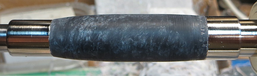

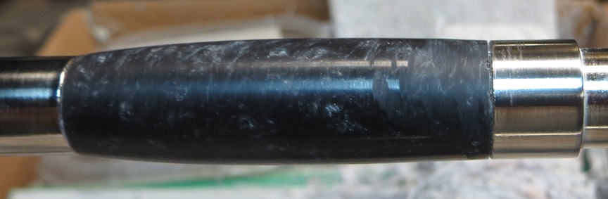

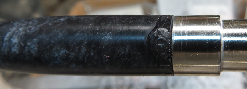

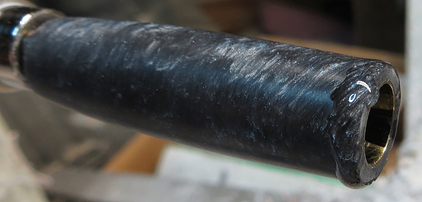

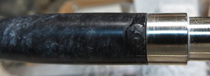

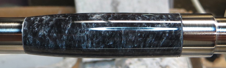

I was doing so well turning Rhino blanks... Got the lower body of this one turned and polished. Then as I was turning the upper body, this happened. I was so close, too. I hoped it would wet sand out, but it was too deep. I decided to try to fix it with thick CA. Don't know if it will work, but I'll find out tomorrow.

I think the CA will do the job. Of course, you still have the task of turning IT !!
Charlie_W
Nov 16, 2011
5,918
Sterling, VA USA
Should work with the CA on this color. If not, part off some of the end and add on a segment of something else. Or if you have a bit of this blank left over, insert a slice of metal and add the matching rhino on the end.

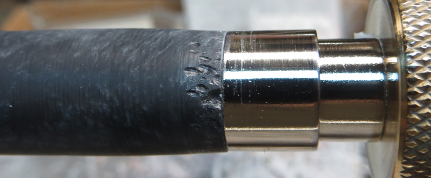

I trimmed it, then carefully turned the hardened CA off of it.

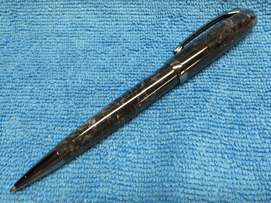

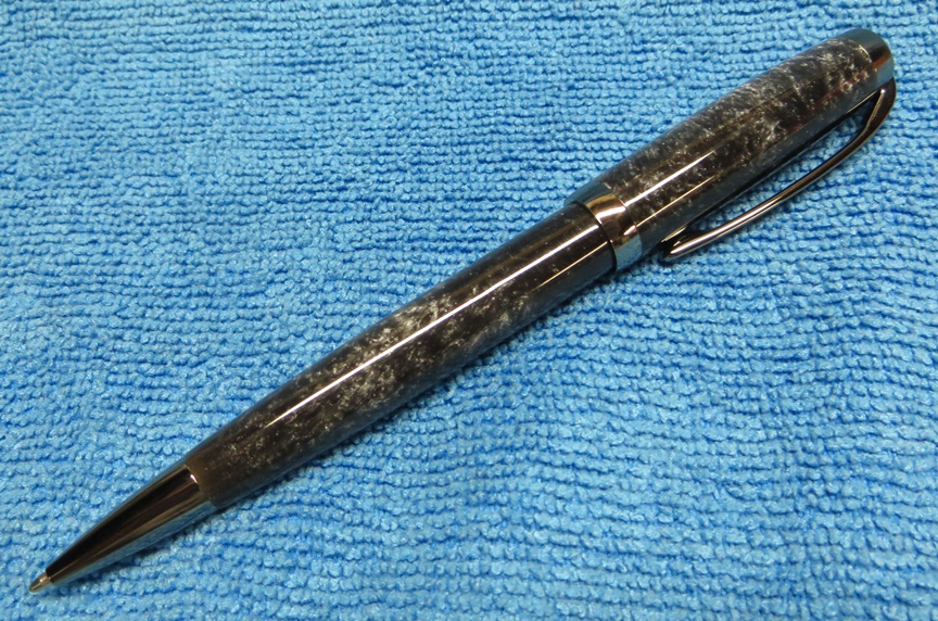

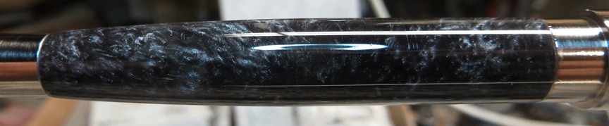

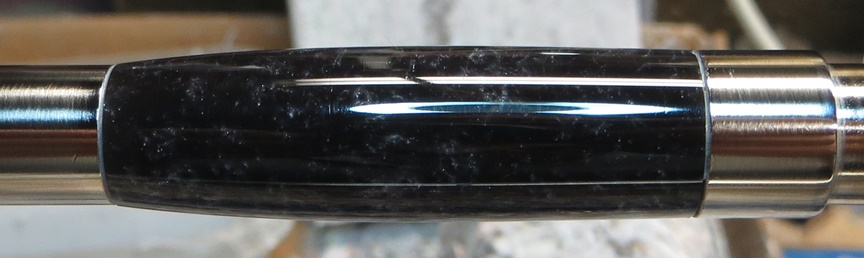

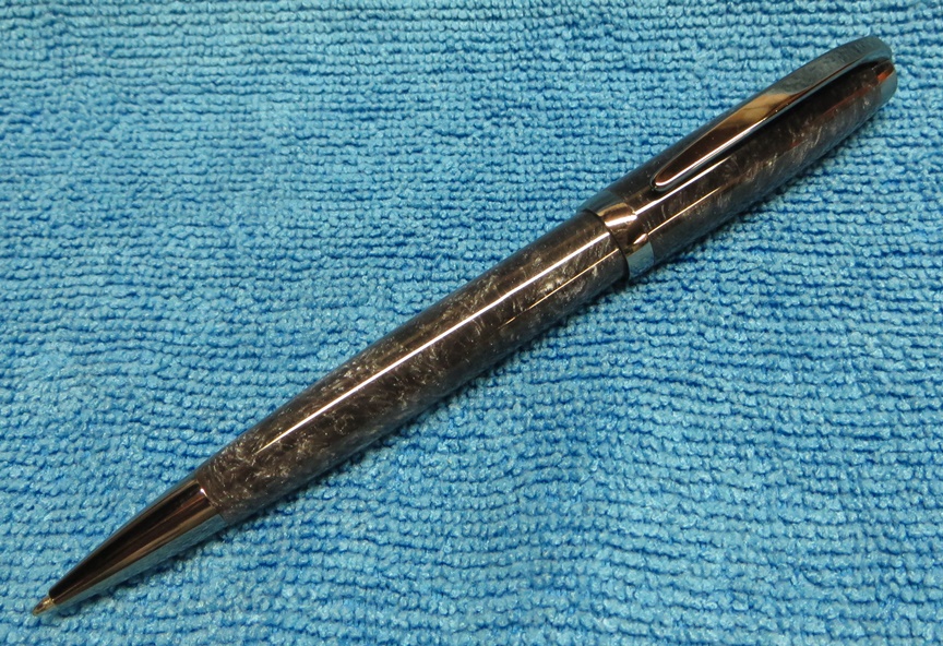

Then polished it with my usual regimen. Wet sand with 320 and 400 grit, wet MicroMesh, them PlastX plastic polish. And I'll be damned. It worked!

Great repair job on that blank... I've been there before while it works well I'm hate doing that kind of repair...
I now take a different approach when turning non-wood blanks.. Once I've turned the blank round I take a sharp parting tool and turn each end down at a slight angle just shy of the bushing. I then go back and finish the rest of the turning with my favorite gouge. At least for me it has eliminated tearing out at the end of the blank.
qquake
Feb 8, 2004
5,015
Northern California
That's a good idea. I may have to try that.
