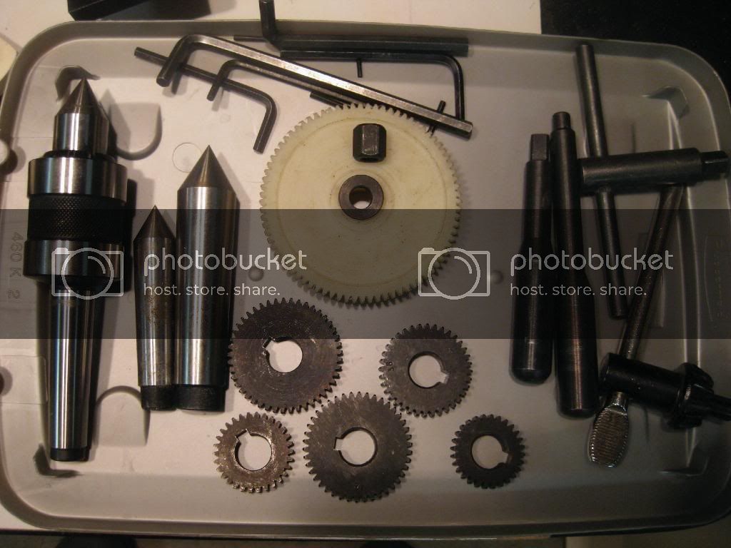

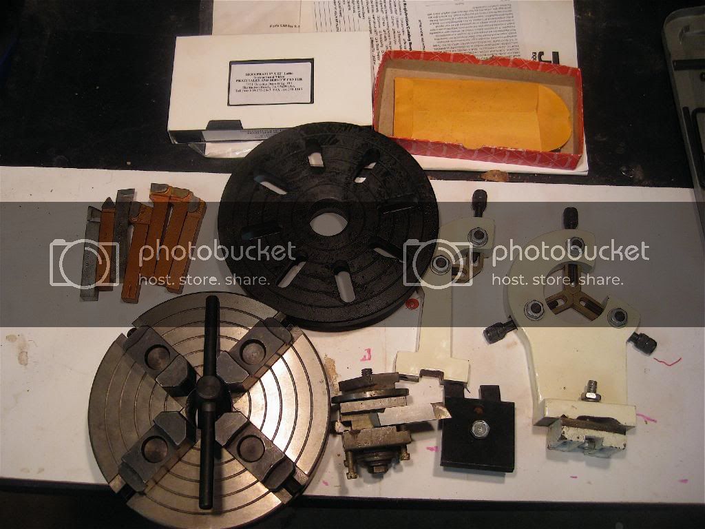

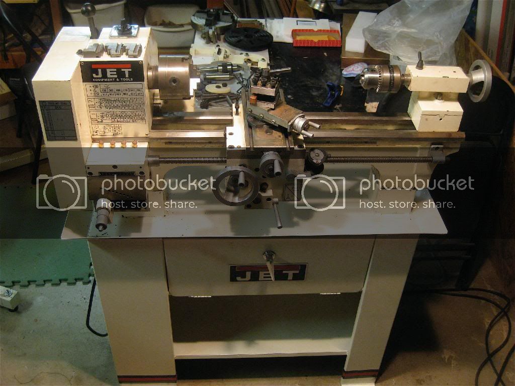

Well here is my new metal lathe
I am stunned
$650
Lathe
Lathe stuff
More lathe stuff
The guy was super nice former machinist who bought this from the company he worked for that folded. Hung out with him for a while as he showed me how to use it. Even helped me load it in the truck.

WOW !!!! That's only about £435 !!!! Absolute bargain:eek: :biggrin:It also hardly looks like it's been used!!! What size is it?

You have some stuff that your are rarely going to use, if ever.
The fixed and following steadies will probably collect dust.
The Independent 4 jaw chuck looks like it is from a wood lathe? I wouldn't use that to spin metal.
I'd buy more cutters, either indexable or ( preferably ) HSS. I also would buy a vertical slide so you can do some milling.
If you haven't already got a coolant system, then don't bother. Plastic spray bottle with soapy water or a can of WD40 does 99% of all my cooling / lubing. I only use the coolant system for slit sawing or heavy milling.
Have fun and get to know your new toy!!:biggrin:

Manny; The lathe is usable as is, but to stiffen the compound slide make of get a better mounting plate for the compound.
Join the 9x20Lathe YAHOO group if you aren't already a member. Check the files section for "The "Donut" Compound Mount for the 9X20 Lathe.pdf" and "The Donut Compound Mount Machining Instructions.doc"
Download a copy of the manual from Jet or Grizzly. One lube point not mentioned anywhere is inside the Quick Change Gear Box. Attached to the lever is an idler gear and shaft. Make sure you oil this occasionally.
