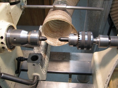

I make my own centers out of Delrin. That's a "revolving" drill chuck on the right. I use this set-up for sanding and finishing. CA won't stick, at least not very well, to Delrin.
You'll have better luck finding Delrin if you look for it by it's generic name....acetal. I use 1/2" mostly and I get it from MSC.

Rick, I think that's the ticket for me. The wax thing sounds OK but if you contaminate the blank with a speck of it, you're toast. I'll check on the Delrin, er, acetal. I have one of those revolving chucks with interchangeable bits, I'll just turn that post down to the chuck size and friction fit it.
Thanks all,
