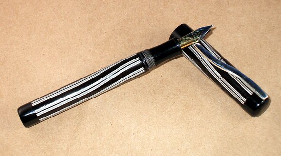

Wow! Double closed-end, hidden clip, custom clip, hand-threaded, custom blank. I'm not sure you could have added any additional degree of difficulty yet you still created a magnificent pen! (And the nib isn't too shabby, either)

Thanks to all for the comments. Blank is from Eagle. Its been in my shop for about 4 months waiting for the design to evolve.
.....and well worth the wait too, Bruce!
Talk about making a splash!!!!
Thanks for showing us this one, it is a true pleasure to see!

Nearly everything has been said.
But I have to comment on the black ends ---
<center>inspired!!!</center>
Hope you don't mind if I use a similar technique on one that's been in MY basement for months. Also looking for the right approach. I think this is it!!! (Though I certainly won't be trying to copy the many completely UNIQUE techniques, pointed out by Lou!!)
GREAT work!!
And the title is appropriate for YOUR work and Eagle's attitude!!:D

You mentioned this at the picnic and showed us the clip, but I still couldn't imagine how nice the pen would turn out. You did a great job, one to be proud of.

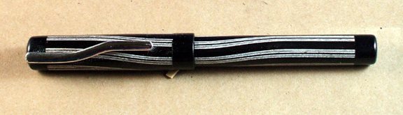

Originally posted by Buzz
What is the clip made of, and how was it done?
Thanks again to all for the comments. The clip is made from a sheet of sterling silver, hand cut to rough shape with a jewelers saw, then filed and polished. 2 pins are soldered on the back side which go into 2 holes drilled in the finial.

Originally posted by desertyellow
Bruce,
Can you share some details about your pen?
What materials did you use.
What is the story behind the clip.
Interested to know.
Tony,
Las Vegas
Blank is ebony with veneers making the wave.
Finial, center band, coupling, and nib end are black ebonite.
Clip is sterling. There is no story, just tried to mirror the wave.
