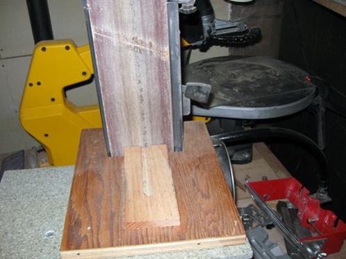

I use the mini disk sander in my lathe and only as a final "clean-up" of the ends after turning and finishing. Works great for that. I square the ends before turning on the types of blanks your mentioned, using the belt portion of my combo sander laying the blank on a simple jig I made.
