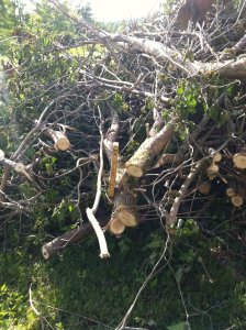

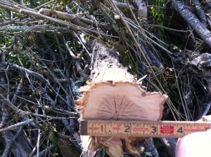

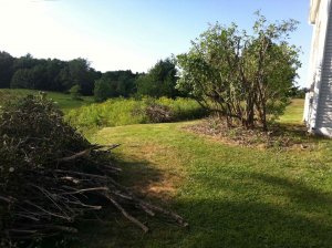

Oh, there's also some pretty big "burl" pieces. I put that in quotes because i'm not positive it qualifies as burl... actually, let me go take some pics, its right outside my door anyway! lol

Nevermind, I just cropped the pics and uploaded them here. Click on the photos by my username for bigger versions!

If I leave a lot of this uncoated, will the checking on the ends extend all the way through the piece?

Just some thoughts as I read this thread. In your close up of the 3 inch diameter. it looks like a lot of splitting has already started. the wood may very well be savable but it is going to take some work.
As far as the "Burl" Better to stay away from that word. Nothing against you it is just a term that tends to get abused. To many people have claimed any wood with anything other than a straight grain is a burl when in fact Burl is a very specific grain pattern as well as condition in the wood. It woudl be safer to simply call it crotch or better yet "Figured Grain" the figured grain is a pretty broad term for anythign that is not straight grain and covers a lot of territory. It will allow you to describe the grain as something other than normal but not leave buyers with a wrong impression.
do get that splitting at the ends under control and I am sure that someone would be interesting in giving it a spin.
Daniel
Jan 1, 2004
5,921
Reno, NV, USA.
I just saw your last question. The cracking is a result of parts of the wood drying faster than other parts the log looses water through the end grain faster than through the side or bark. The sealing of the end is an attempt to slow the loss of water at the end. and yes the more the wood cracks the faster it can loose water through the end. the cracking can get so bad it may very nearly split the log in half. in this case it is jsut fracturing the log in small pieces. regardless it will continue through the log.
as the log dries it will shrink but you want the log to shrink as equally as possible all at once. not from the ends inward.
