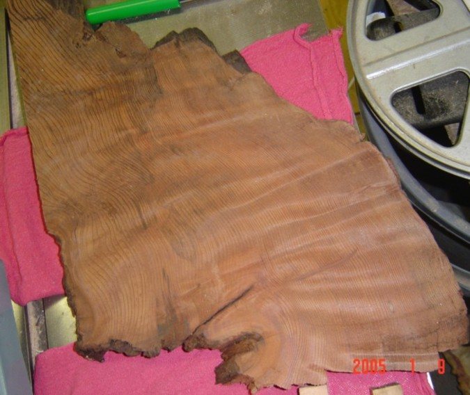

I came across this piece of Curly Redwood the other day at one of the guys where I buy wood.
While the curl is nice, it's going to be too thin I think for pens. The grain however is very exceptional, with some very nice tight, well defined growth rings.
Being fairly new to pens, which way would you cut this piece for pen blanks if it were you? With the grain, diagonal to the grain, 90 degrees to the grain?

How about cutting two adjacent pieces and glueing them face to face, bookmatched faces together so you end up with about normal thickness for a pen blank. I have some thin figured walnut I am going to try that on. Could also put a piece of contrasting wood in between.

I think you are correct, there are places on there where some would look fantastic cut on the bias, and others would look best with the curl showing. Why not try laying out the different cuts with a piece of chalk then using the band saw to cut them out. That way you could maximize yield, while still getting a mix of cuts from the one piece.

Cross grain ALWAYS has a nice effect while longrain may sometimes be iffy.

I personally would not cut it at a 90 to the grain. I find that about 13 degress or there abouts will give real good grain figure without making ti more dificult to turn. When you cut straight across the grain you end up with alternating end and face grain. This can cause tool chater and some wood is more prone to blowouts in a cross grain configuration. If you are careful, of course the results are nice but I still like the bias better than cross cut. Just my 2 cents worth.

Thanks for the great suggestions. I'm sorry when I said thin, I meant the 'curl' was going to be too thin, as in not close enough together to show well in a pen. The wood thickness will be okay.
