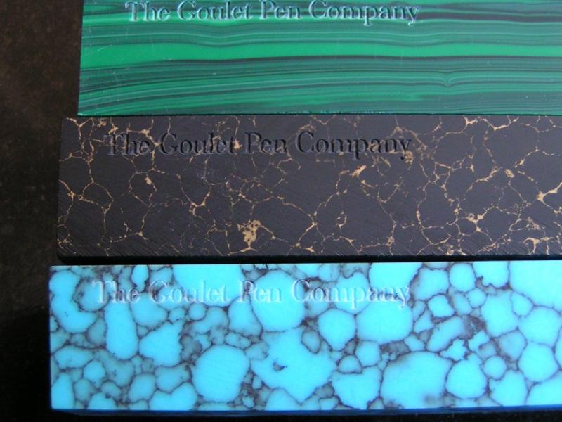

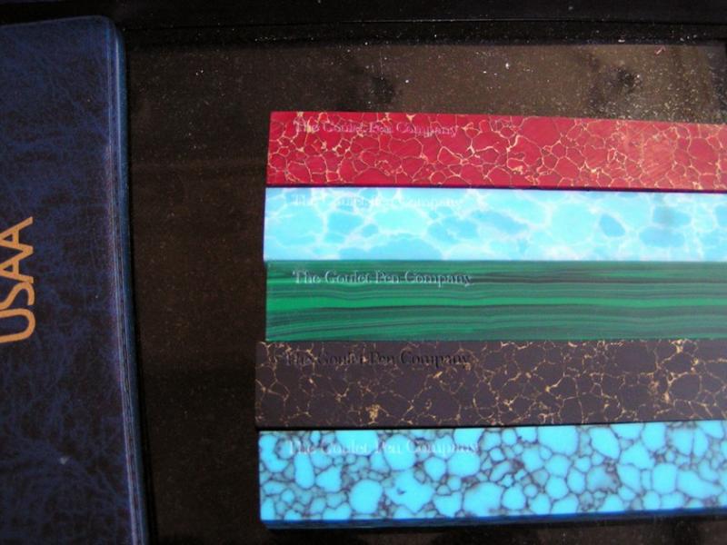

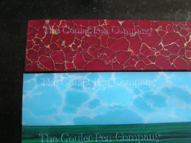

Okay, here's how they engraved. Now this was on square blanks, but should give a pretty good idea. The malachite was the only one that kiiiiiiinda looks okay, but I'm pretty sure if you want the engraving to be seen at all then backfilling is in order. Enjoy the pics!

It probably depends on what type of trustone you're engraving. I engraved mine using an Epilogue 45 watt with 30 speed and 100 power.
