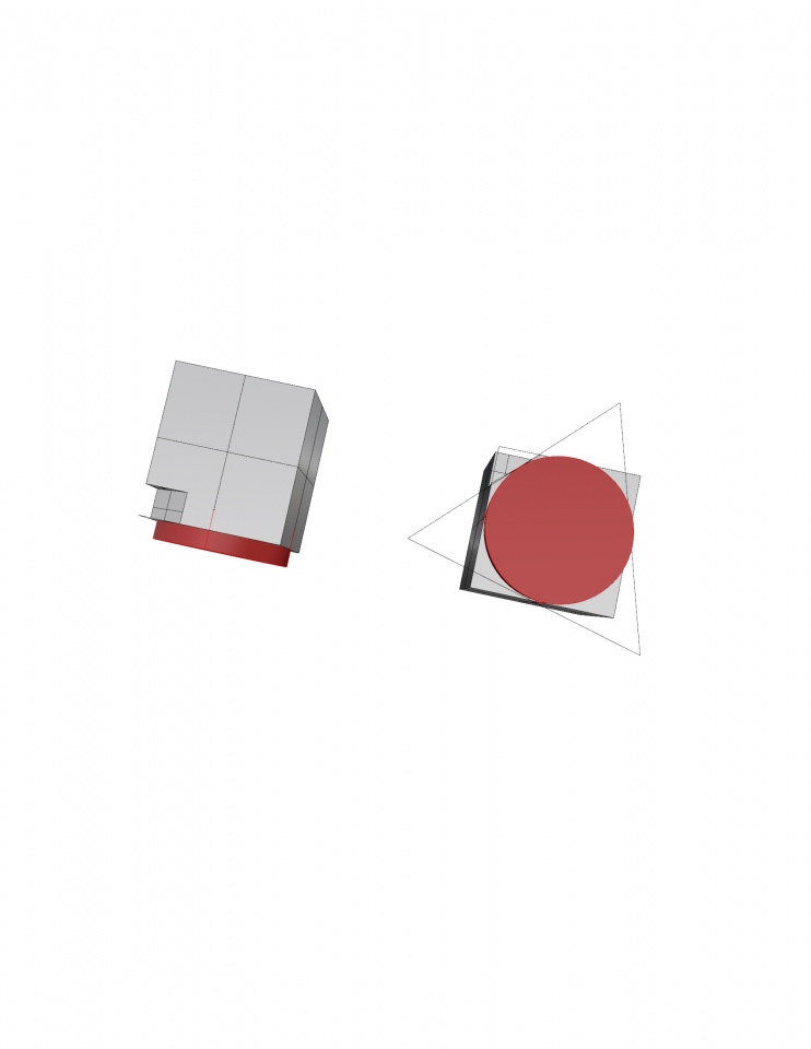

Its also possible using a 3 jaw chuck. You sand or grind one of the corners flat to make a short notch. That notch sits on one of the jaws and the other two grab at the sides of the blank. (left Picture)
Its easier if the blank is oversized but it can still work. In the right side picture I have a 3/4 square blank with a 3/4 round shown in red and a triangle drawn on the end shot. YOu can see the jaws would be able to grab the blank to round it.

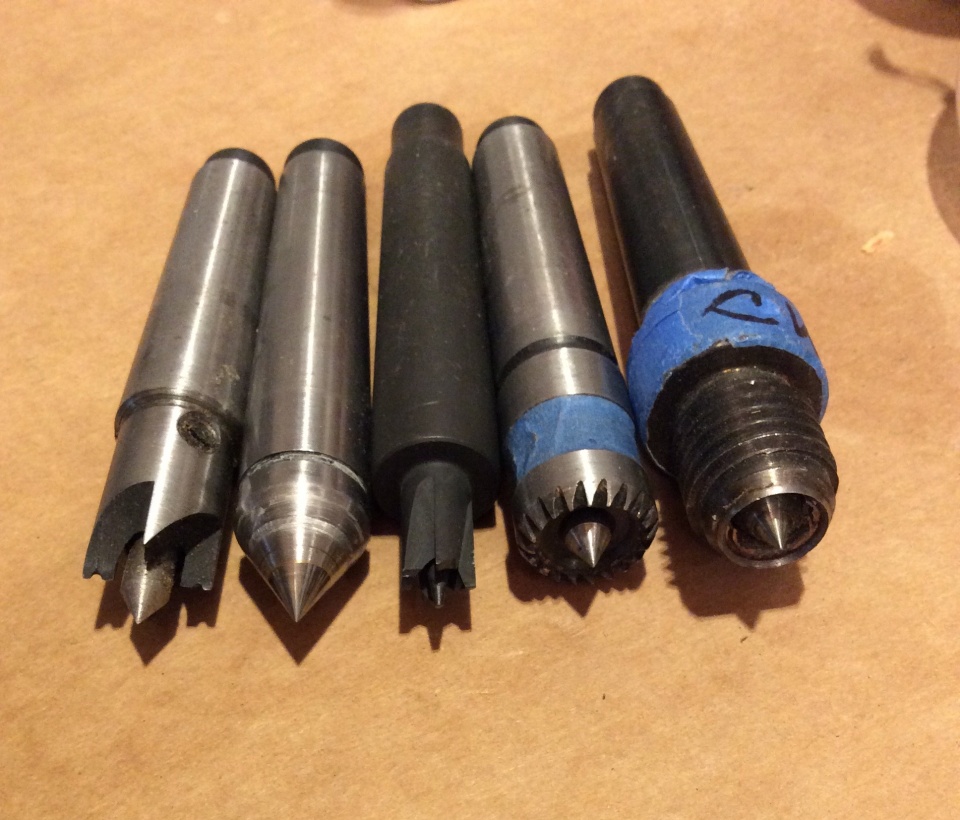

Here are a few #2 mt drive centers.
I use the ring center(safety center) on the right for much of my smaller spindle turning.
Remember, all you need to turn is just part of your blank so you can get it secured in your collet chuck. Then you can finish rounding.
I still use tailstock support as much as possible.
