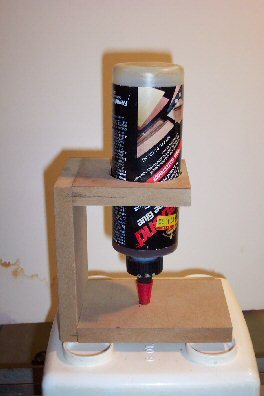

Another good way is to store your bottle upside down . That way the air is in the bottom of the bottle and any hardening will take place there and not in the tip .
I've been storing my Polyurethane glue That way for well over a year now and it's still as good as when I first opened the bottle . It says on the bottle that the shelf life is 6 months after the bottle is opened and as you can see , I've extended that by over 100% .
I've attached a pic to illustrate my storage method .
I hope this is a help to someone .
