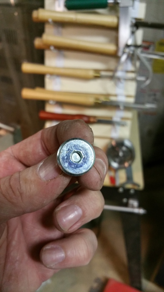

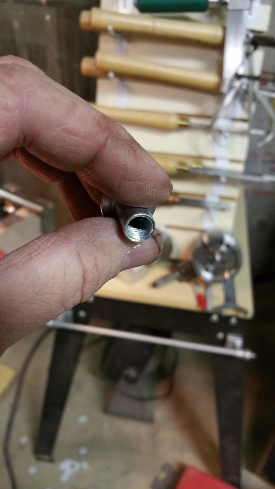

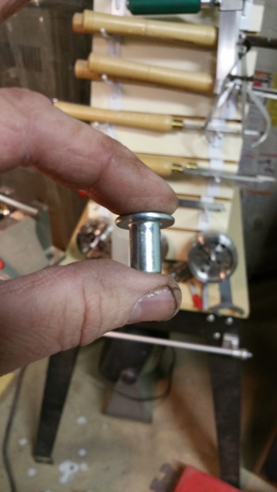

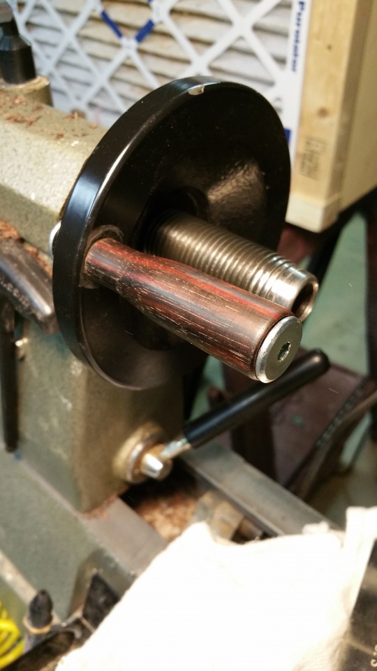

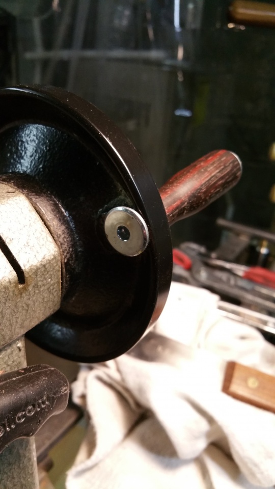

Hey Fish! I was in the same place you are and I came up with a solution that is working so far. I say so far because this is the second version of my revolving handle...the first one didn't revolve very well and I've only drilled out a couple of blanks so far.
The first two are the finished handle from each side. I used some hardware left over from an Ikea sofa I took apart a long time ago, but I think anything similar would work.
I drilled the hole out big enough for the nut to be pressed into the wheel. It is a tight fit so it won't be loosening up on me (I hope). On the handle, I drilled it all the way through large enough for the threaded rod to fit loosely, but also opened it up on the end for the nut to be able to spin as well.
The last three pictures are just the nuts I have at either end of the section of threaded rod that I cut to length.
BTW, what part of the burbs? I'm in the NW part, up around Acworth.

Thanks and you're welcome. I had to drill it out. I looked on McMaster-Carr's website a little and wasn't sure about anything they offered, so I just went with this. Makes cranking on that hand wheel a lot easier.

I don't actually remember what size it was. I basically went as small as I could to make it break loose. If I remember correctly, there is an indentation on the back side where the handle is pressed in and I just grabbed a bit that would fit inside that indentation. When I added my "fancy" new handle I had to open the hole up so the t-nut would fit, but that was just based on the caliper readings of the hardware.
