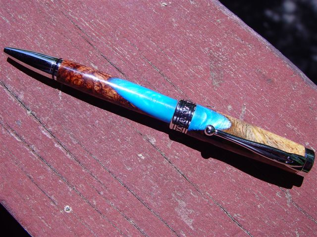

Finishing a pen that must be sent to daughter tomorrow. Using Novus #2 for the first time and directions say to polish until dry. When polishing on the lathe, the heat can build up until the plastic finish starts to melt. Should I really polish until dry? Have polished some with the Novus #2 and shine is really coming out, but it seems there is still some overall dinginess to the finish. Perhaps this should be posted in finishing...but might not get a "quick read and response"

Don't run too fast and use the Novus 2 wet. IF it dries, just use a little more. Put it on with a soft rag, and don't use a lot of pressure. Apply light coats, until you have the shine you want.
Yes, avoid HIGH heat. If you can touch the blank without smelling burning flesh, you're pretty much OK>

Try moistening the rag or paper towel also, it keeps the Novus
working smoothly longer for me. Dry novus was never good on my lathe,
only when ready to buff off maybe, but not while working it.:)

I use Novus 2 on every thing. I run the lathe at full speed. DO NOT let it get dry heat is your enemy. If you build too much heat you will scorch your blank and ruin your finish. So keep it wet not too much pressure then slow it down and wipe it clean.
That's what I do.

I definately was doing it wrong. Would let the polish work until dry then try to polish like a dry rub...oh, wait....thats BBQ...now I know where I was going wrong. Thanks a lot....hope I can recover the finish. Its on an Amalgumutt of Rosewood (sap and heartwood) and blue stuff. I might need to back up to the CA and reapply.

If you did what I think you did scorched it. Then you will most likely need to refinish it. No big deal easy to do just lightly sand the whole blank with some 400 or 600 till the bad spot is gone. Then reapply your CA and sand it back up through the micro mesh numbers. I wet sand on CA and only go to 6000. Then use a strip of soft cloth put a dab of Novus 2 on the cloth work it in so the cloth is wet. Then polish at full speed with light pressure. If it starts to get hot or dry STOP re wet your cloth. You want to keep your cloth wet it will get gooey. Then slow your lathe down or stop it and hand buff it.

Well, finished the pen. It did not finish as shiny as I had anticipated as areas were blochy, but will continue to develop the process. One additional thought, after each reapplication of CA the surface seems to be a bit pitted and rough, thinking the solvents in the new coat might be reacting with the previous coat. The blank was polished from 1500 to 6000 mm, then NOvus 2. What CA is normally used; I might have obtained a bottle that was rather old on the store shelf and now need to buy more since the bottle is empty. Thin fast, average or thick slow setting. All three are available from the suggested source, plus one with rubber-like additive which I assume might be to attach waste blocks to turnings. Which CA is normally used for finishing the pen. I am ok on the tube stuff; in a test, without scuffing could not remove the tube even with pliers.
BTW thanks a lot for your help. Attached the pic to show finish problem. My first pens without all the mm and NOvus were better but forgot how I did it.
