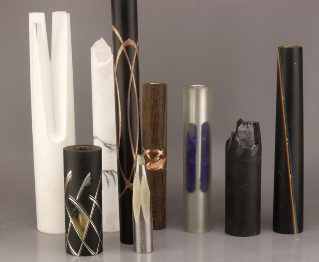

How many times have we heard something akin to.... "I was almost finished turning the blank then WHAM... I got a CATCH and a chunk came flying off". Every time I read one of these posts I can't help but think... "How far was their tool rest from the blank when it happened?"

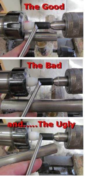

The closer your tool rest is to the blank, the less likely you are to get a catch...... regardless of what kind of cutting tool you are using! The farther the tool rest is from the blank, the greater the chance is of the tool trying to grab and take a nose dive over the tool rest!
Since the majority of us are self taught through trial and error with little formal training, how many of you pay attention to the distance between the tool rest and the blank or even know that it matters?
I taught myself how to (incorrectly) use a skew and at a local turning club meeting was complaining about what a crappy tool the skew was and how it caused catches one after another. So, the next weekend a seasoned turner invited me to his shop for some one-on one instruction and he taught me how to properly use a skew. When showing me how, he had the tool rest about 1/8" from the work piece. At that distance it is almost impossible to get a catch unless you really try. After a little practice, I learned the importance of tool control, which includes the all important tool rest position!
So, is anyone guilty of starting out with the tool rest in the proper position then not moving the rest closer in as they turn down the blank, thus widening the gap between rest and part?

I have also learned this lesson. I have also had tool rests made for me that allow me to get closer to the work when working with a chuck or tailstock. The rests are handy when doing miniature work. This is a good topic.

I do mostly production turning and a "catch" ruins my day. I use almost exclusively "alternative materials, and don't have the luxury of using HSS tools. A catch with a carbide cutter can mean tossing a blank that was almost "money" and STARTING OVER, out of production cycle. This means cutting a new blank, drilling again, back painting the hole- AGAIN, waiting for paint and glue to dry - AGAIN! In short, a HUGE waste of production time.
My methodology (and I certainly DON'T advocate it for the leisure turner) is somewhat different than most here, simply because I need to make a LOT of product in a short period of time.
Once all of the square blanks have been cast, dried, cut and drilled, I take them to the "jigged"router table, and "nose over" the blanks to almost round. I do it this way simply because I can "round over" about 50 blanks in about 5 minutes.
THEN, when I mount them on the lathe (and with razors and "Sierra" that's three at the time), I move the tool rest as close as humanly possible. Since the blanks are "mostly" round", that is almost always Less than 1/8 inch. I RARELY get a catch.
In our shop, my wife and I laughingly refer to a "catch" as being one mad monkey shutting down the entire circus.

Getting a small (narrow) enough tool rest for TBCing smaller blanks is a huge necessity. The stock rest on my lathe won't get anywhere near a sierra blank when turning between centers. I bought it for small kitless parts, but use it all the time now.

I use the Pen Pro and as stated in another post it's impossible to get the tool rest 1/8" away and still have good support for the tool. I do move the rest as close as possible and readjust as needed. Rarely have a catch and have never messed up a blank, but I'm sure one of these days it will happen. Oh wait, I did have an experimental blank crack. It was a wood/acrylic segmented blank and one of the segments came away. This was due to an improper glue coverage, not a catch.

I have not thought about it in so long I never really realized how often I adjust my rest. But I completely agree. Keeping it close is critical. Certainly during those final touches. THE material is beginning to get very thin on many pens. Turn some slimlines it will help perfect your technique. Nothing like shaving wood down to veneer thickness to revel any flaws in your habits. Then turning some of the thicker bodied pens seems easy.
I will repeat the advice, Use a skew as a skew. Keep the tools sharp which has always been an echo rebounding around here. We can now add to that, Control it. If anything keeping the rest close is accomplishing just that. It is giving you control of the tool. You would not try to draw a straight line without a straight edge. Don't try to freehand your turning either.

Most catches with a skew come when lose bevel support, so ride the bevel and do not force or rush the cut. Easiest way to learn how is with lathe off holding skew in one hand and rotate work with the other.
