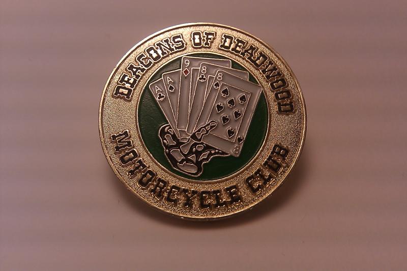

I was approached today by a potential customer who is affiliated with a motorcycle club that wants me to make pens for a charity auction. She gave me a medallion from this year's charity ball and it has their logo on it, and she initially asked if I could incorporate their logo into the pen, but later in our conversation she said I could also incorporate it into the box and that would be just as good.
I feel like putting the logo on the box is an easy way out, because it's just a matter of shipping it off to an engraver...but the logo on the medallion is way too big to wrap on a pen, not to mention the fact that I've never done a logo in a pen before.
Any suggestions? I've attached a picture of the medallion in case anyone is struck by an idea for something I can try...

I'm worried that the logo/decal wouldn't fit on a normal pen, though. Just for size comparison, the center circle of that medallion is the size of a quarter...and if you shrink it, I'm worried you won't be able to make out the details of the logo at all.
I've not yet done a CA finish, although I have everything I need (Accelerator and thin CA just arrived today!).
I'm considering maybe doing the full logo on the box, engraved and maybe burned in, and then just the club's name engraved on the pen...

I scoured their website and came up with a couple images of the logo...of course, if I were to have this engraved, I would need a vector version of it, right? Or at the very least, a b/w line drawing? Or do most engravers convert plain images themselves?

I wouldn't worry too much about the size. Get a jpg, gif or tif image of the logo and start from there. I usually use Photoshop (or Paint works too I think) to sharpen up the image. Play around with different sizes.
A "quarter" sized image may not be too bad on a Sierra. The circumference of a Sierra is approx 1-5/8".
I usually print different sizes on paper and then wrap the paper around a pen barrel to check.

If you can pull an image from their web site you can play with the size by reducing it slightly, or putting a slight bulge in the pen to take a larger one and make it into a decal.
It's when I see logos like the one you showed at first, makes me wish I knew how to do jewelry or make stuff out of metal. It would make a cool finial to a pen, but I think that is way advanced stuffed.
