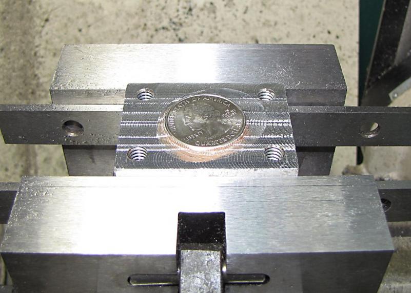

I wanted to play around with an imbedded quarter pen. I have read where some of the more experienced pen makers sand coins thin so they can be wrapped around the tube or braid. I have a mill so thought I would mill a KY quarter thinner.

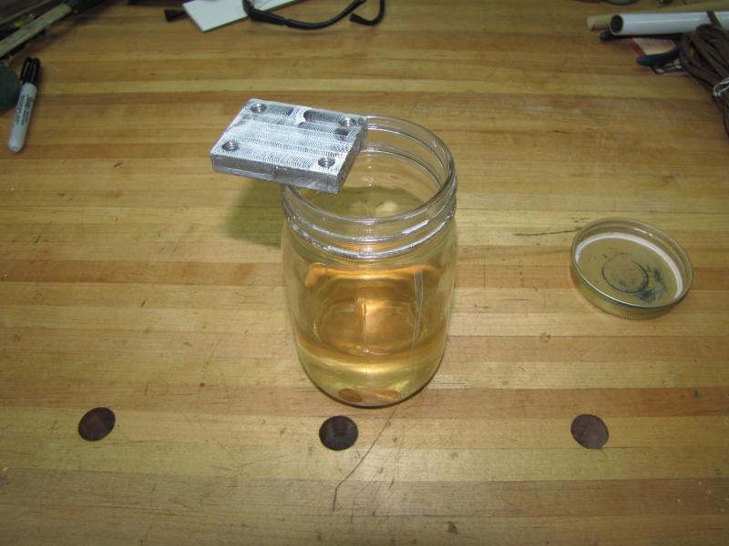

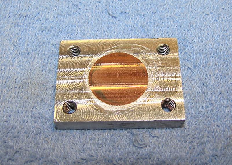

I CA glued it to a trued up block of aluminum.

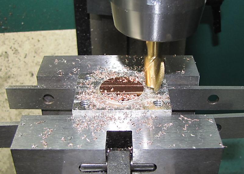

Milled it down to about ~0.020 from its original ~0.067.

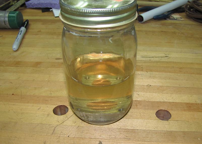

Dropped it into some acetone overnight.

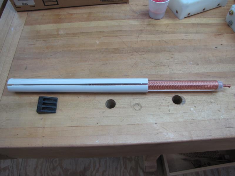

Wrapped it around a copper braided cigar size tube. It was much harder to wrap then I expected, lots of rubber mallet time around a HF punch. This is where the question comes. I stopped milling when I saw the color of the metal change from copper to silvery metal and was afraid I might go through. Can someone tell me if it would be safe to go further, don't want to waste a very hard to find quarter.

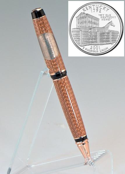

Even though it was tough to bend it didn't come out too bad except I would have preferred a black braid rather then copper. Have some on order now but...

Now a question for you, what did soaking in acetone do for you?

i'm guessing it released it from the aluminum block.

As noted below the acetone released the CA glue.

I am a long way from doing anything like this, so I can't help you on your questions, but I think it turned out real nice.
Thanks Stephen.

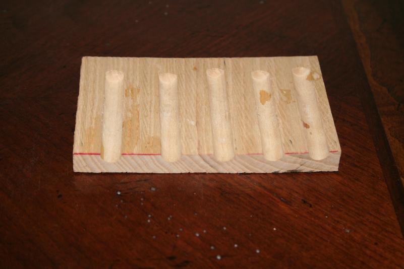

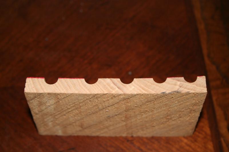

Maybe I can contribute something here. Drill a board on its edge the diameter you need. (See attached photos.) Then split the board on a band saw. This will give you a "cavity" that you can lay the thinned coin in and using a dowel rod press/hammer the coin to fit in the cavity. I use this to curve coins and also watch parts for my watch pens.
So what size tubes did you setup that piece of wood for?

I used the same size drill that you would use to drill the blank for the pen. Then I found a bolt with a smoth shoulder to "Roll" the coin to fit the tube. Starting with the drill for the blank that made the coin a little smaller so when it springs back it will be very close to the right size for the tube.

Sorry I just looked at the pictures Healeydays posted. I use a 2x4 drilled through the narrow or 2 inch side. That way when cut in half you can lay the rolling pin all the way across to keep the coin straight and lay flat along the tube. I'm sure I didn't explain it the way I should have but hopefully you can figure that part out.
