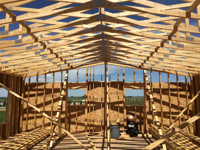

Ed I tend to use most of the shop when making furniture as I move around to each station or roll a machine to the wall and move another for more space. While some machines are generally stationary, like the lathe's, others like the table saw and planer/jointer get repositioned a lot. I haven't ruled out having the room "halved or quartered' with their own switches or use dimmers if the LED's can be dimmed.
Chris at the moment being in a position to make blanks is a bit premature. If the picture of the shop as it was a couple days ago attaches you'll understand.
