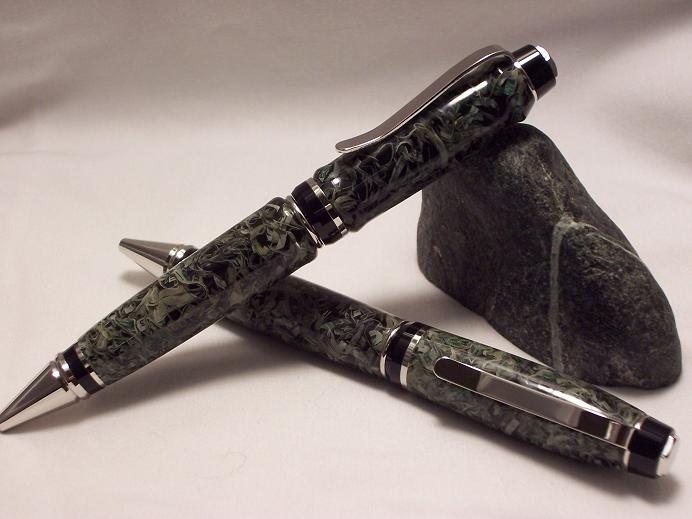

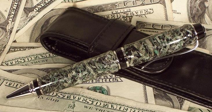

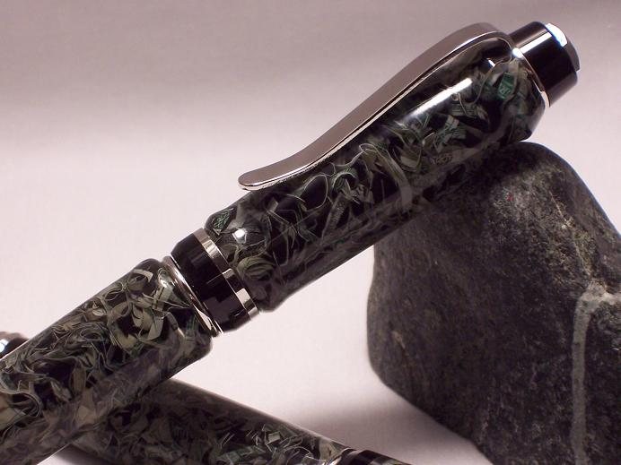

So how much money do you guys actualy put into your pen blanks?
Pen I turned for the '06 PITH for bradbn4.
A pair of pens
A close up of one
I tried to do a CA finish on them. One turned out OK the other I had to redo the lower barrel and that finish came out good. Any tricks to CA on PR? Let me know what you guys (and gals) think.

I used the water bottle ice cube trays and stuffed them with the shredded money(I got a bag of it one year as a present). This is old money the govt has shredded and resold. Using clear PR I add it to the tubes slowly using a long wood or plastic skewer to work the bubbles out as I pour. About 0.75 oz of resin per blank. Pressure cured overnight 40psi. When truning the blanks you do cut through the strands on money. I seal the pen with CA when I'm finished. I painted the holes in the blanks black after drilling as well as the brass tubes. I used 5 min epoxy tinted blank for gluing.
I found fewer strands look nicer than packed full. I would be willing to trade some of these blanks with folks. let me know if you want to do a trade (PM me). I'll have to pour some more blanks this weekend.

Yeah, that's my problem, I used a dowel and slam packed it with bills. I dont think it's going to turn well at all, so I'm holding off. I just wasnt thinking, lol
Next time you make one, try painting the tube white or very light green and see if it brightens up the blank. It looks dark in the photo.
