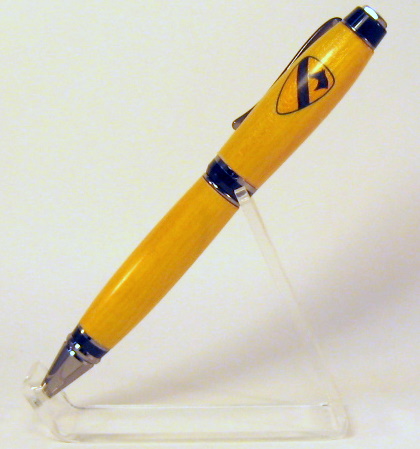

I think they make nice pens too . Take a look , and you decide .

How long does it take for it to lose it's color? I am sure it depends on the amount of light but ballpark is what I am looking for. If I make a pen today, would it be a month, year or tens of years before it has appreciably darkened?

Someone is sure to disagree with me but my experience has been within 6-12 months it really gets noticed it is changing. 10 years? Prolly looking at a very nice golden brown pen.(Still nothing wrong with it but it wont be bright yellow anymore.)
You pretty much answered the question yourself.
In full light, such as near a window, it will begin darkening immediately and be very brown within a month.
An artists sketch pencil I use as my shop pencil (hard lead) is kept in the pencil pocket of my shop apron. It is out for only short periods of time for use then back in. So it receives relatively little exposure to light. It has sorta 'tanned' over the four years I have had it.
Hope that helps a little. Exposure to UV is what does the change. And, sorry, UV inhibitors in finishes don't really help much.

Can someone post a picture of something that has turned dark? I love the color of the pen that was posted here but am curious what it looks like after it turns. I purchased a decent sized piece from Woodcraft a while back and was planning to use some but want to know what the final product will be.

yes that has darkened but im surprised at how little. perhaps windows dampen the effect??? im not sure but ive seen it a whole lot darker than that. almost like Ipe-brazilian walnut, but it always looks stunning. i imagine at a certain point its a matter of taste. i know that as a costomer (had i never heard of this effect) it would probably be all the more interesting to own one.
only problem is (on bows anyway) it always stays much lighter under a leather grip, so watch where you store it. i imagine that even in direct sunlight the bottom would stay lighter. if its used (moves about) in the sun this shouldn't be a problem, i would imagine it should darken quite evenly.
